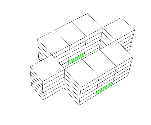

My objective is to know the effect of an interior courtyard on the thermal comfort inside a room with windows on the interior courtyard compared to a room of the same size with windows on an exterior facade (see model below).
When I simulate the model, the results obtained for these two classes are strangely very (too) similar. It seems that the software does not take into account the presence of the interior courtyard.
For example, the heating loads are the same for both classrooms while logically, the heating gains should be higher for the classroom facing the inner courtyard because of the shade generated by the building and the fact that the other classroom is facing south.
Can someone help me or tell me if this is an error on my part or if the software cannot take into account the shape of the building with the interior courtyard?

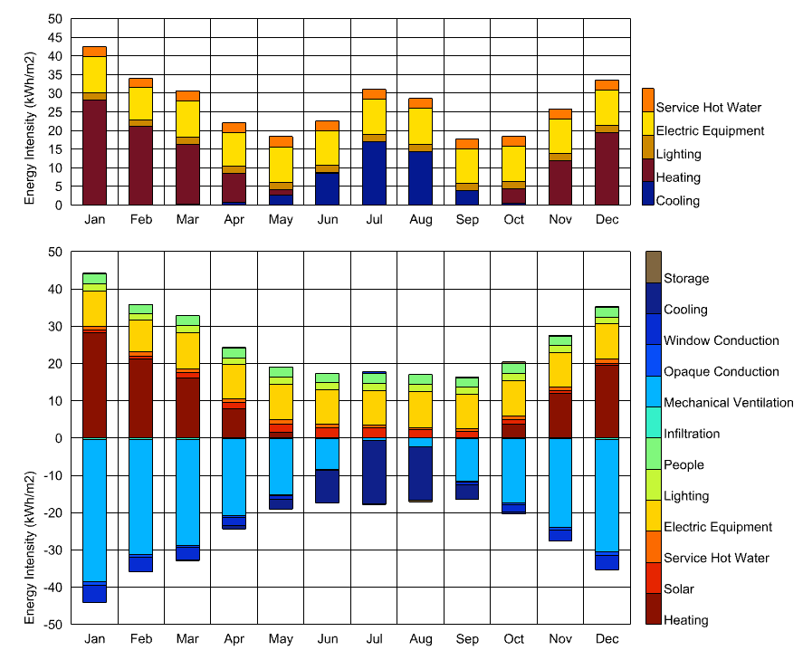

The answer for this type of question is usually to run an Annual Load Balance. That will tell you if the solar and envelope loads are significant enough for this space to make any difference on the heating and cooling. For example, the solar gain has a practically insignificant effect on the thermal load balance of this hospital patient room that I produced this graphic:
More information on how to run an annual load balance is here:
