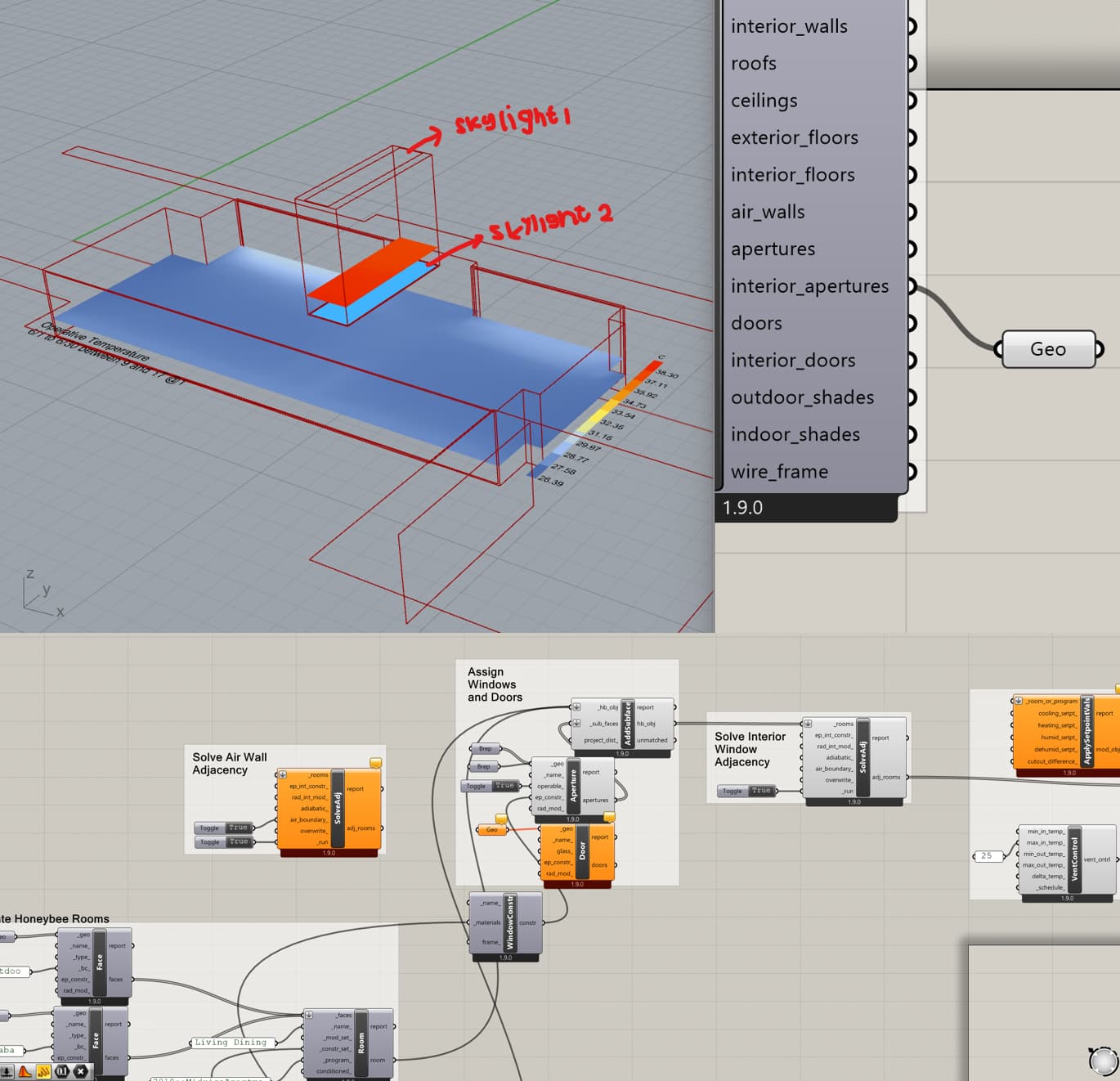

Hi friends, I’m trying to simulate indoor temperature of a room. So the room has a skylight (1) that has contact with the outdoor and 2nd layer of skylight without outdoor contact (2). However, when I tried to simulate it, the temperature of the room especially right below the skylight has no sign temperature increase.
I believe there’s something i did wrong with the adjacency but I can’t seem to find the problem. Could anyone help me with this? thank you very much.
You should set the floor between two rooms as air-boundray for energy simulation.
