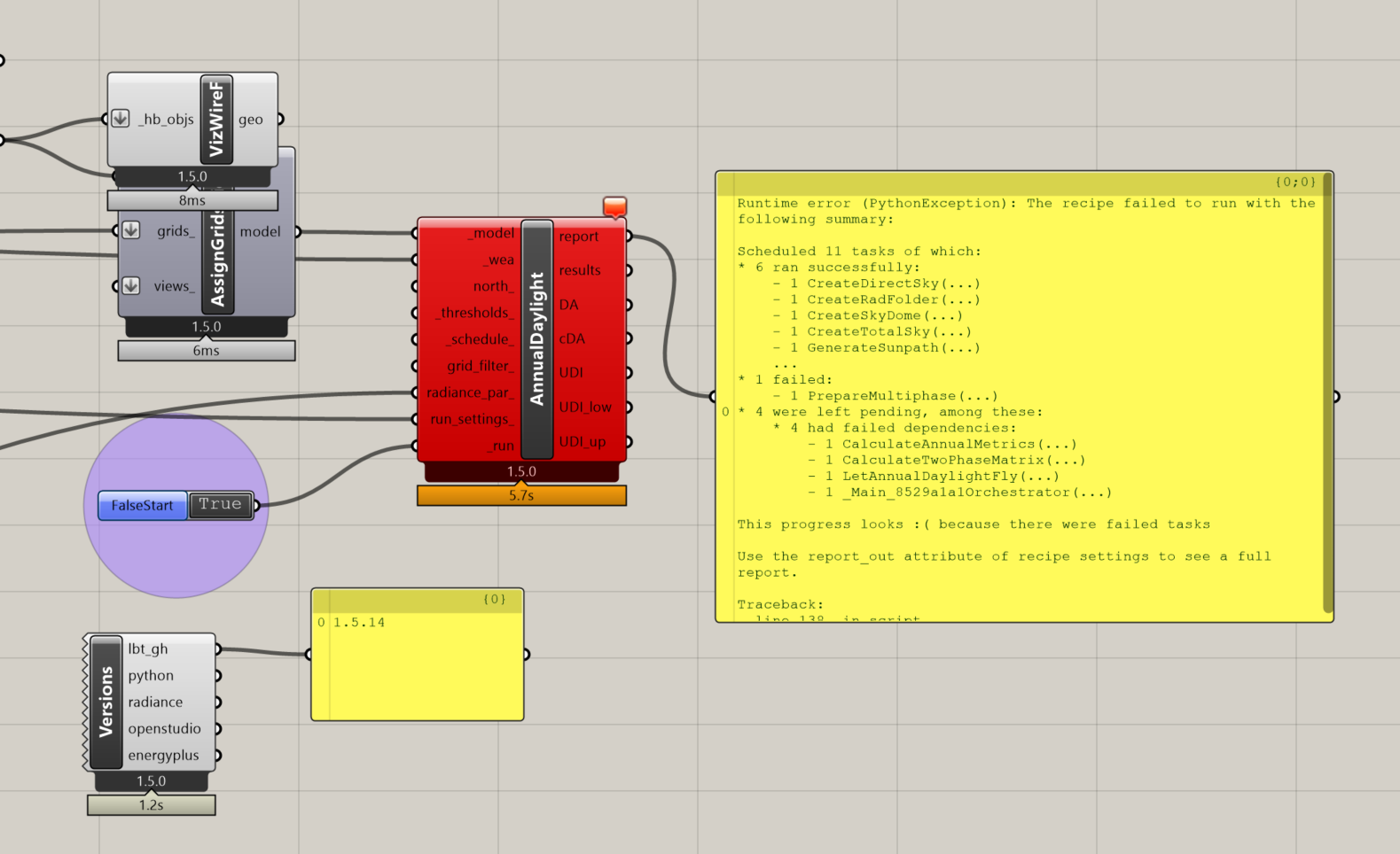

I’ve done what you asked, here is the result using ao’s script:
I’m on version 1.5.14, which was released 2 days ago. Your reply above is 1 day old, it possible the update didn’t go through?
You are right that the update is not in 1.5.14, but in the development version that you should get when you run LB Versioner. If that is not the case, then I think we need @chris for this.
ok great, at least we found the source of the problem. Indeed, it seems I don’t get access to developer’s version through versioner. Wouldn’t it be easier just to do a new release with the bug fix?

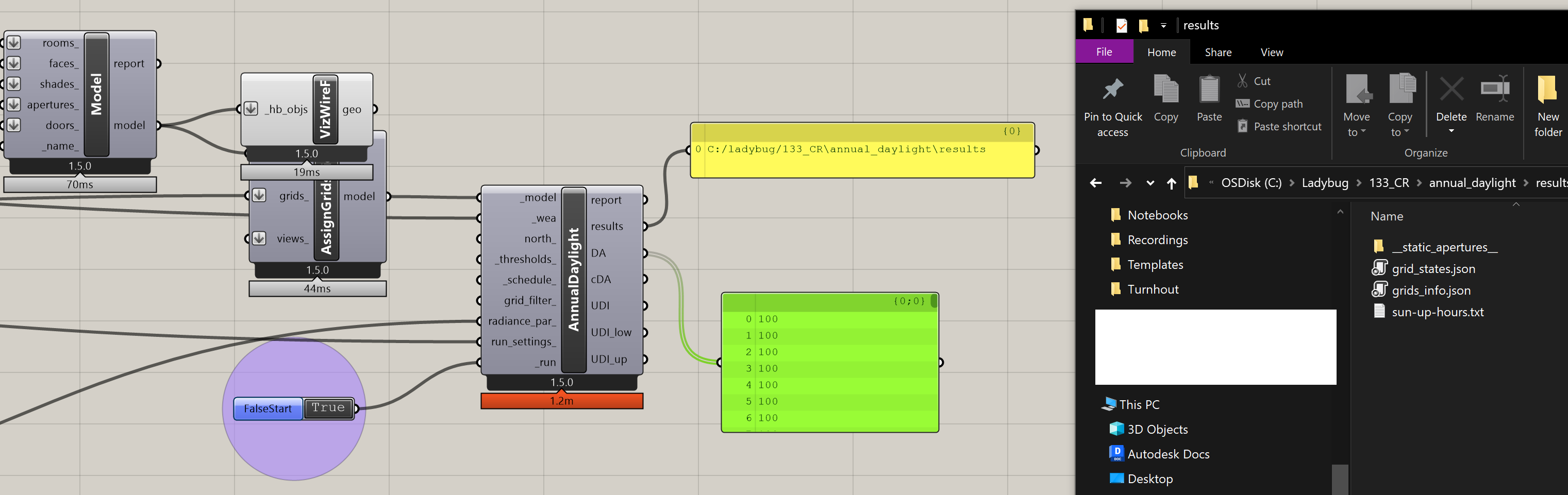

oh, found another bump on the road, now on version 1.5.17. So right now the daylight is running, I get results from the component, but the .ill files are not written on the disk. See the screenshot below:
No errors coming from the component this time. Is this still a leftover from the light_path code change?
Hi @pmcmm,
The results are in __static_apertures__/default/total but they are stored as .npy (NumPy) files. This is one of the recent changes of the annual-daylight recipe.
oh, I see. That way it reduces the amount of time lost converting the .ill into a numpy array, smart
Yep, this one was my fault. There was a dependency conflict across the LBT core libraries, which was causing the Versioner to revert to some older versions of some of the libraries. I fixed it yesterday and it should all be good going forward.
