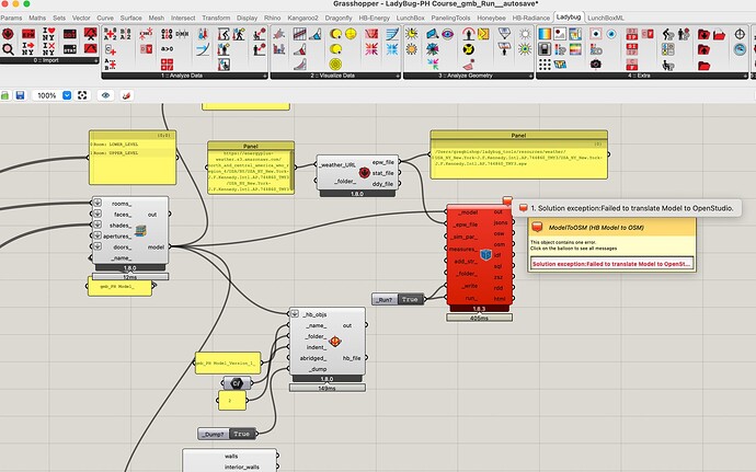

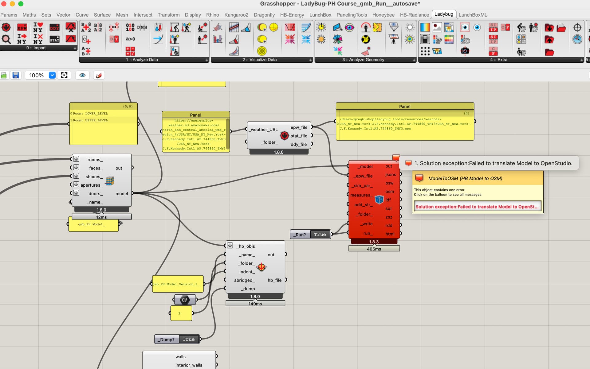

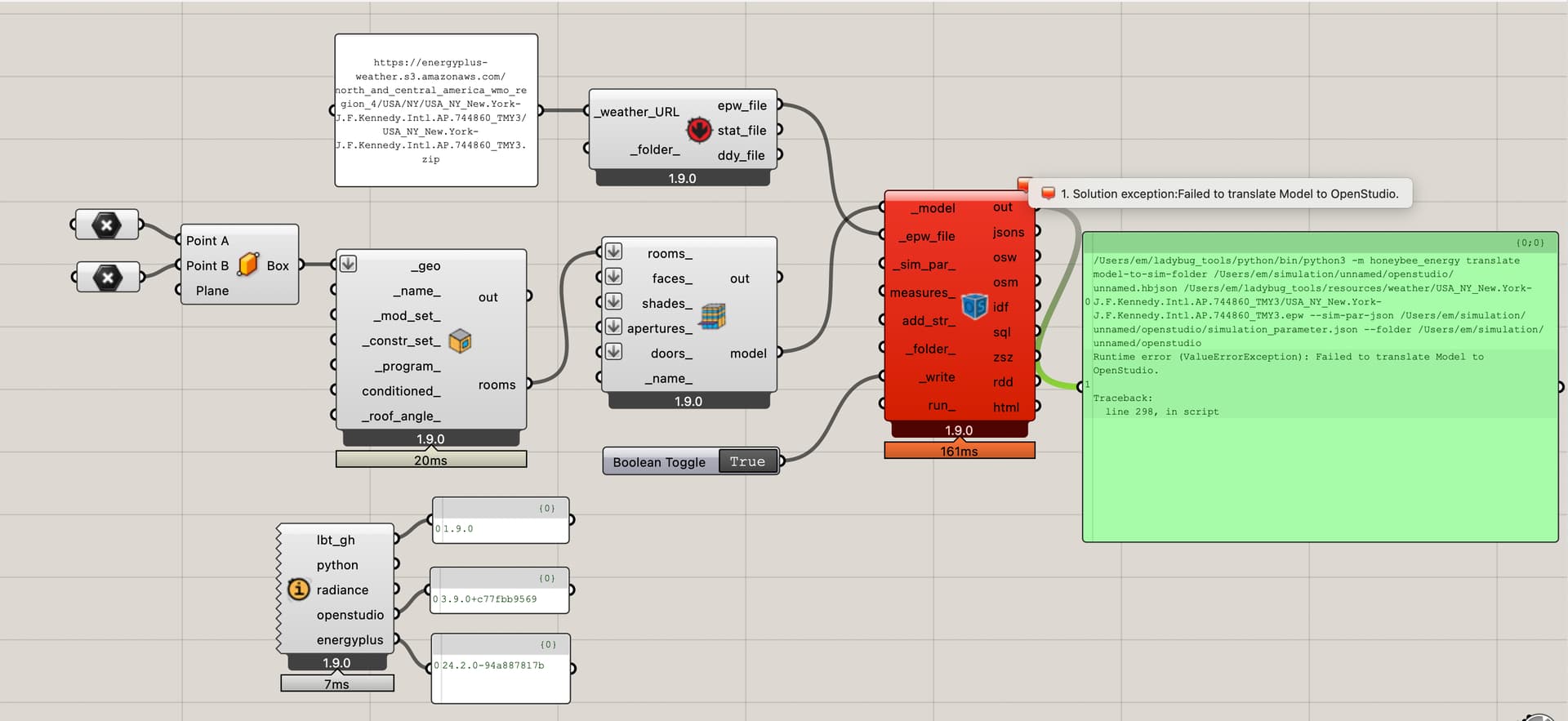

New to LadyBug and HoneyBee. The model is previewing correctly in Rhino but when I try to output the model to “ModelToOSM” I get Solution Exception Error. Thanks for any insight.

I am running Rhino on mac, and have fully updated everything to their latest versions. (See screenshot). However I am still getting this translation issue, is there anything else anyone might be aware of that could casue this issue?

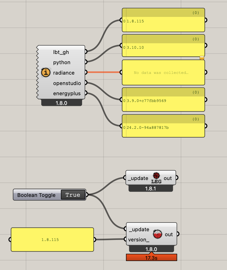

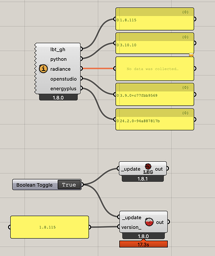

I just ran the ‘LB Versioner’ to update to v1.8.115, and installed OpenStudio 3.9 (as per the compatibility Matrix), and I can confirm that this is now causing a Failed to translate Model to OpenStudio error on MacOS.
Environment:
  • Apple M1 Max (2021)
  • MacOS Sequoia 15.5
  • Rhino v 8 (8.21.25175.17002, 2025-06-24)
  • LBT Version 1.8.115
  • OpenStudio v3.9

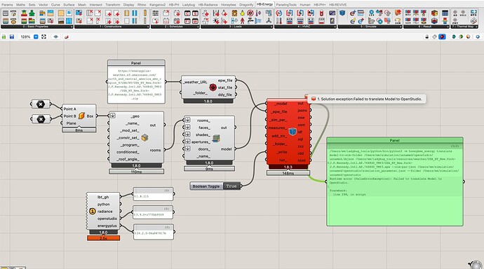

@chris , do you have a suggestion for how to track down where the error is occuring?

@edpmay
Example File:

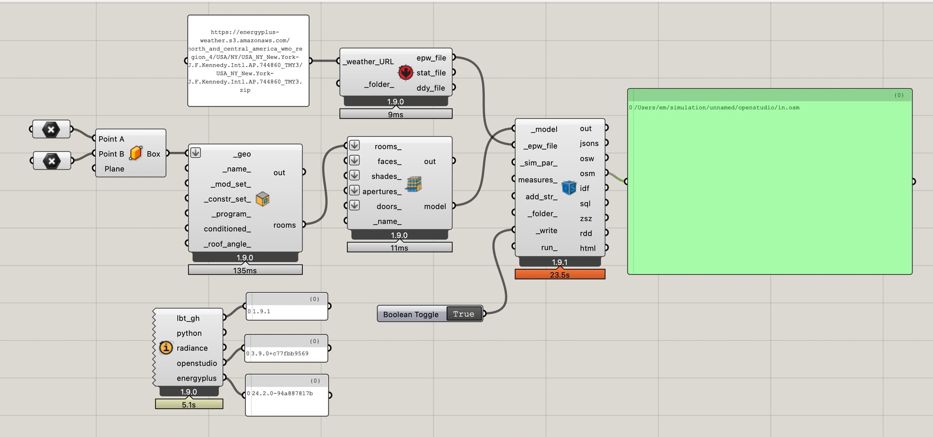

Gosh, wat a dumb bug this was. I’m pushing a fix now and I’ll update the installer on Food4Rhino.
Ok, the fix was merged here:
… and I just updated the LBT 1.9 installer.gh on Food4Rhino with the fixed component.
So all that you have to do is re-download the LBT 1.9 installer and run it (or use the LB Versioner component). Then you will have version 1.9.1 of the “Model To OSM” component that has the fix:
I really should have checked this topic 3 days ago as I was finalizing everything for the release.
That is perfect! Works just right for me now:
