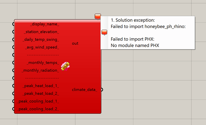

I ran into a roadblock today while trying to update your component. It keeps displaying as ‘Old,’ and when I hover over the component error, I get the following message:
1. Solution exception:
Failed to import honeybee_ph_rhino:
Failed to import PHX:
No module named PHX

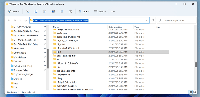

Hi @Luke ,
Sorry for the trouble there. The error there appears to be related to some sort of library installation trouble? When Honeybee-PH installs, it should (if it is working properly) add new code-libraries into your:
C:\Program Files\ladybug_tools\python\Lib\site-packages\...
So for instance, once installed, there should now be a library named ‘PHX’, and one named ‘honeybee-ph’, and so on…
so, first, can you check this location and let me know what you see there?

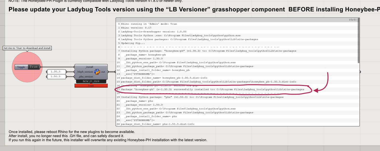

second, can you let me know what you see when you run the Honeybee-PH installer? Does it give warnings or errors when you run it? It should, if working right, give detailed reporting of what it does and where it installs things?

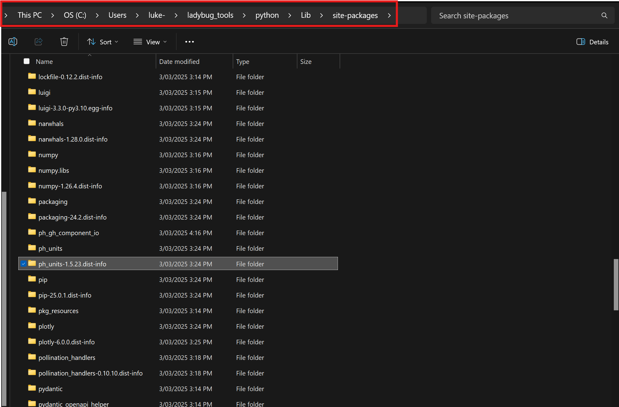

Hey @edpmay,
Thank you for your reply. You are correct, there is no library named PHX in that directory.
I have played around with a few things and it seems to be an issue with my computer as I opened a virtual machine and it installed correctly. I believe the error is indicating that python does not have permission to modify xlwings.xlam even though Rhino is running in admin mode. I tried to reinstall xlwings but that didn’t resolve it either. Any insight on this would be amazing, I’ll post the full installation message bellow and highlight anything that seems concerning in bold:
