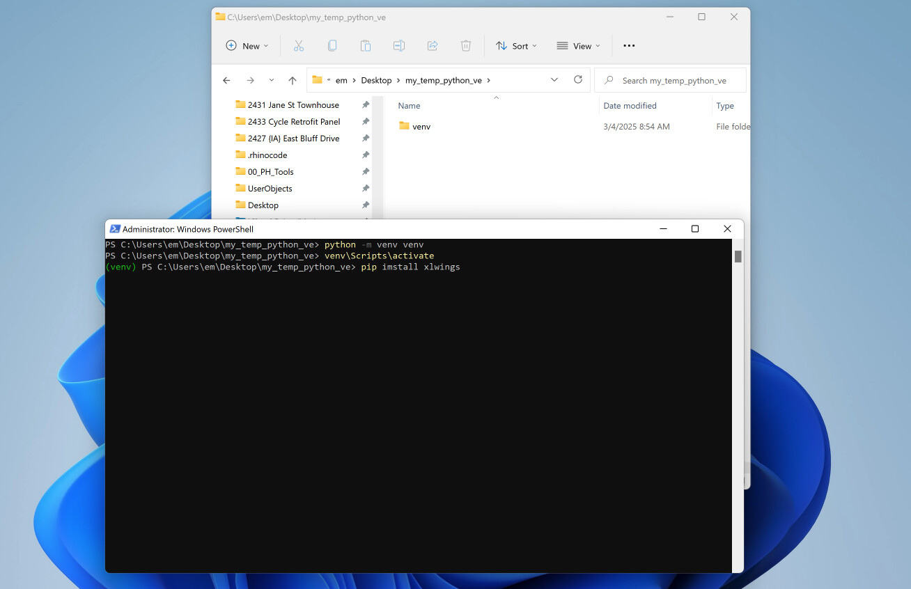

What sort of system are you running here? What OS version, what Rhino version? I know there were some other problems with XLwings in Rhino recently, but I thought those were isolated to the Python3 interpreter? Honeybee uses the older Python2 IronPython interpreter, so I didn’t think that would be affected?
Are you able to install XLwings if you start a new Virtual Environment (outside Rhino/Honeybee) and just run pip install xlwings ?
To try this:
  1. Create a new temp folder someplace (Desktop, etc…)
  2. Open this folder in PowerShell of sim (as admin)
  3. Create a virtual environment using: python -m venv venv
  4. Activate it using: venv\Sctipts\activate
  5. pip install Xlwings using: pip install xlwings
See if it installed without any errors?
