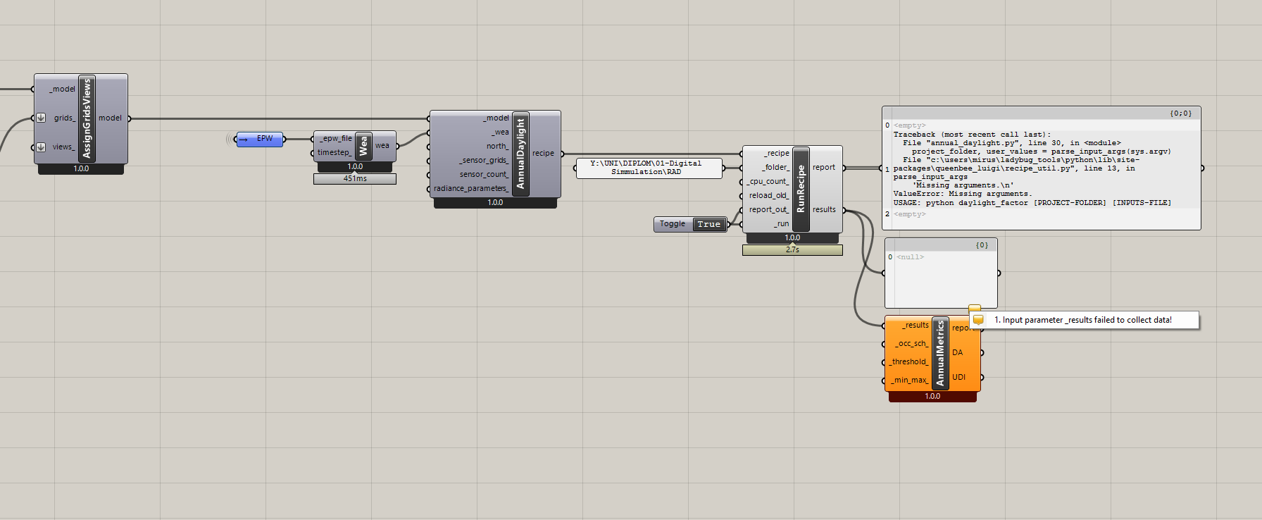

so I am just getting started with Ladybug and Honeybee, I have downloaded and installed the latest Version (1.0.9)
I am having trouble running the Annual Metrics - it seems that the RunRecipe Component is hitting some error.
Any help is appreciated,
Cheers!
Miruna
What happens when you disconnect the _folder_? Grasshopper might not be authorized to write there.
It worked!
