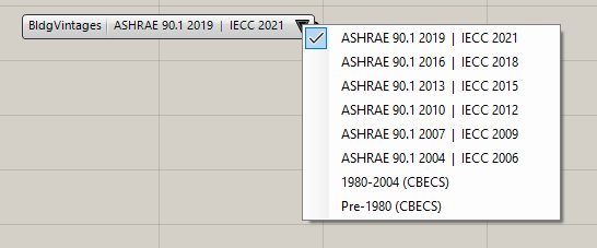

You’ll have to be more specific about what standard you want to make defaults for. As I understand it, a lot of Europe uses the International Energy Conservation Code (IECC) and you’ll see that the templates you have labeled as “ASHRAE” also correspond to versions of the IECC:
If you have a more localized and less international standard in mind, feel free to post it and maybe someone on the forum has worked on making constructions and objects for that standard.
