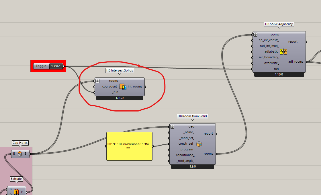

I am having a problem with Honey bee simulation, and i narrowed it down to HB Solve Adjacency as when i remove it the simulation works fine, when i have it connected i get this error: 1. ** Severe ** CalcHeatBalanceInsideSurf: The temperature of 129765.02 C for zone=“TARGET_2_AC9AA0C9”, for surface=“TARGET_2_AC9AA0C9…FACE0”

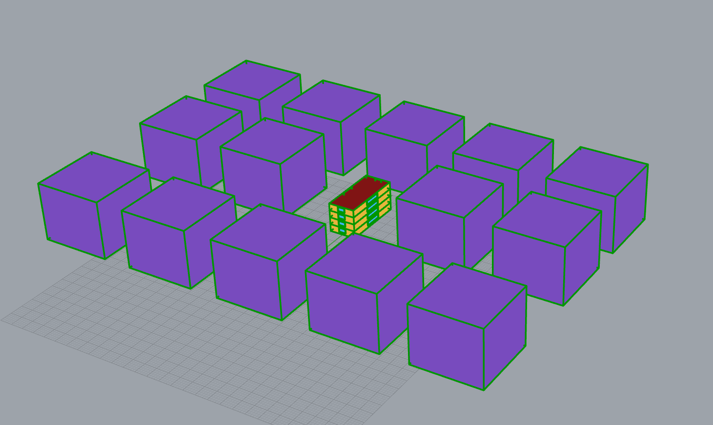

all of the masses are created in GH, and it is a simple multistory building, with simple context, all i need is to define the slabs between floors as internal

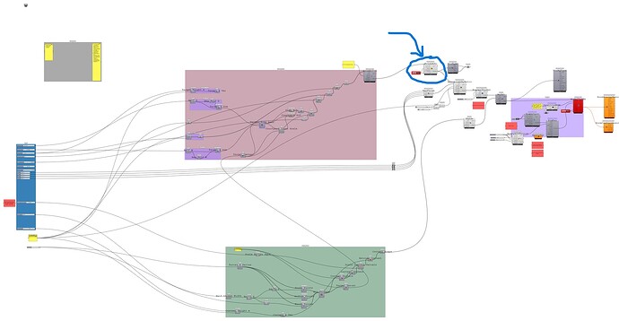

here is the image of my model and work flow.
Edit: it does work fine with up to 5 floors, mre than that the error occur.

hi @GeorgeMench so this component isnt needed since the faces already match up, because of that the component is likely trying to create additional faces so I removed it from the workflow and ran the simulation and did not receive the severe error stated above.
I tried with both 3 and 8 stories
You can narrow down the issue causing using List item and use HB visualize component to see it.
