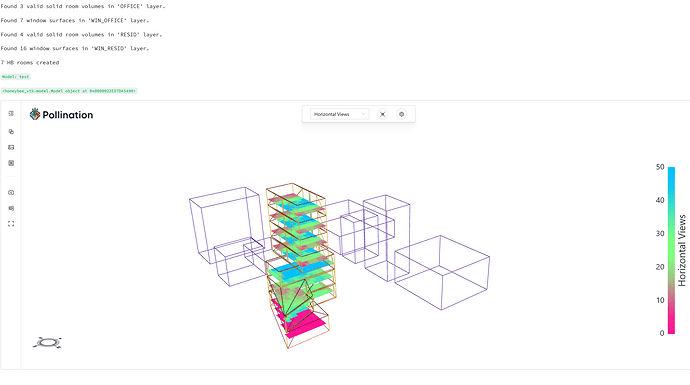

Here’s how I’m currently setting the colours using 'view_study':
cs = ColorSets.view_study
vtk_model.sensor_grids.add_data_fields(all_results, name=study_name, per_face=True,colors = cs, data_range=(0, 50))
Many thanks in advance :pray:
Juliana
Hey @jucroffi ,
Yes, but you’ll want to set up your VTK visualizations as VisualizationSets. Any VisualizationSet can be translated to a VTK visualization using the ladybug-vtk package. So this completely bypasses the use of the honeybee-vtk package, which is essentially deprecated at this point. If you are working from a Honeybee Model, then you can use the honeybee-display package to translate your Honeybee Models (and Radiance results) into a ladybug-display VisualizationSet.
If you look at the attributes that are available on VisualizationSets, you will see that any AnalysisGeometry under a VisualizationSet can have ladybug-core LegendParameters assigned to it. Ladybug LegendParameters allow you to assign any colors you want, which will be carried through to the VisualizationSet and VTK visualization.
I hope that helps.
