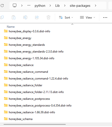

I’m trying to make LBT work on Uni computers and ran into the same error. After connecting False to the Enhance input, the error turns to - 1. Solution exception:run() got an unexpected keyword argument ‘silent’.
The scrip works well on my personal computer.
Syncing/updating LBT versions didn’t help. I tried to uninstall LBT from the Uni computer, and install it again, the error remains.
All site packages seem to be in place.
Rhino path search is set up to the correct folder.
