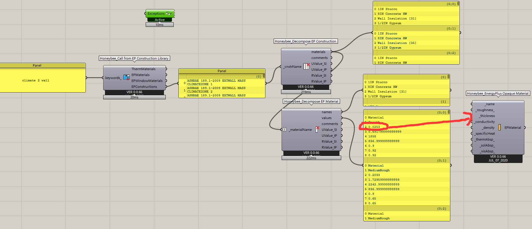

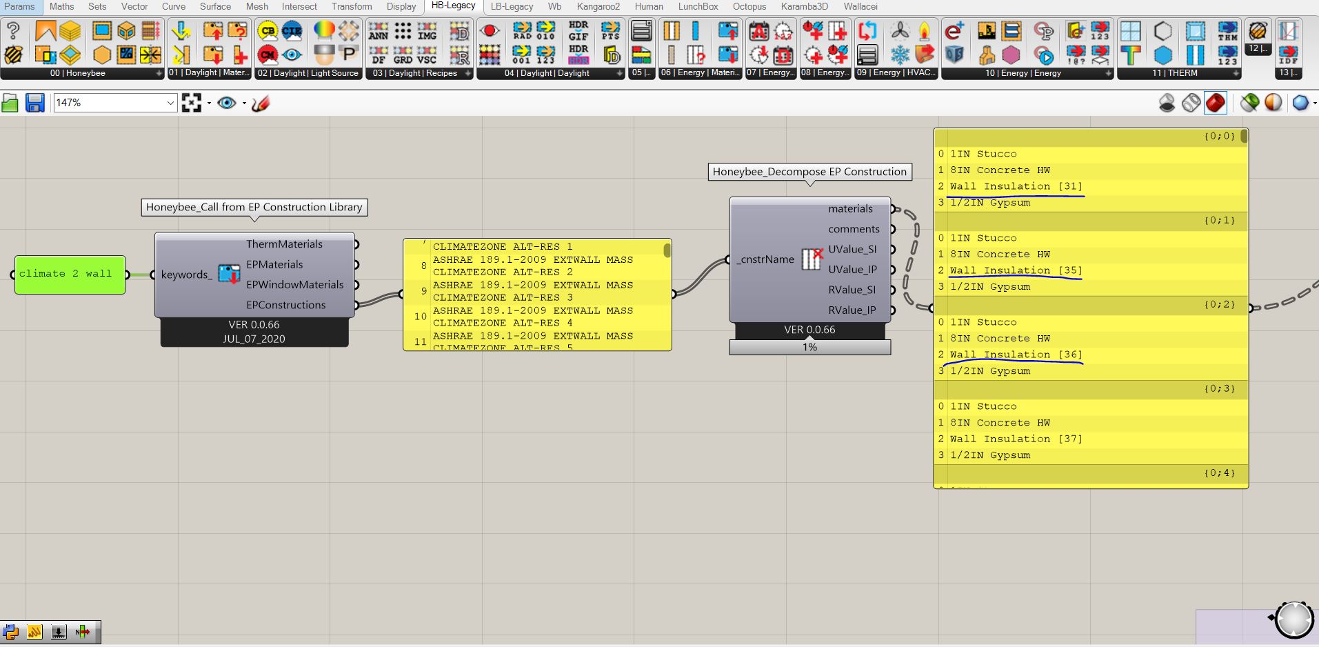

Hello everyone,
How can I know the thickness of each of these insulation boards?
Many thanks
Ahmed
Hi @aaalyahya You can use decompose EP material compotent to check the thickness of each material layer.
Many thanks for you @minggangyin
