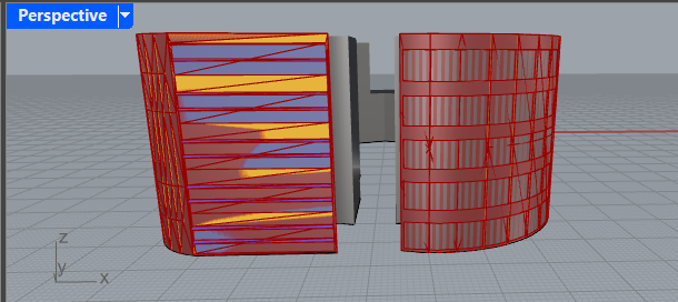

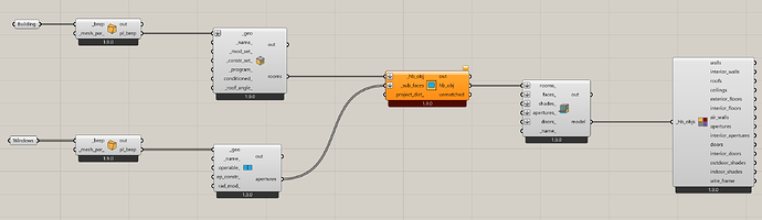

Hi @Naga,
Sure thing! As you can see in the image below, the building on the right (with curved surface) is what I would like to assign aperture on with the help of “HB Planarize Brep” however I am getting the error message on “HB Add Subface” of ‘The following sub-faces were not matched with any parent face’
Appreciate the help!
-LH
Rhino image:
GH image:

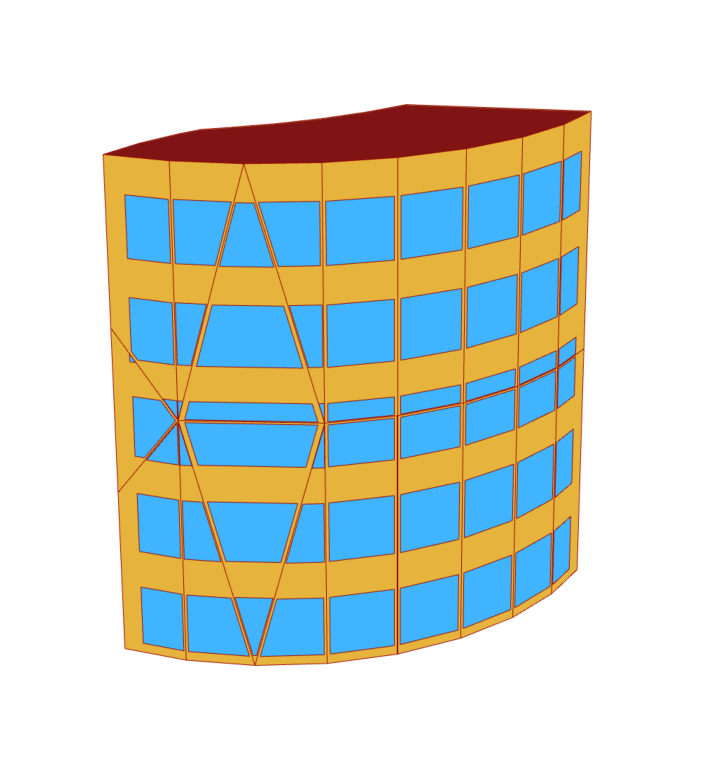

Hi @LostHopper
The reason for mismatch is the surface configurations when you planarize the curved facade and window surfaces. To visualize the difference you can connect outcomes of HB rooms and apertures outcomes separately to HB Visualize Quick.
There is a computational design trick to model the window surfaces on curved facades, which is detailed step wise below -
  1. Using HB Visualize component, export HB room output to geometry.
  2. Now extrude the unplanarized curved facade window surfaces geometries into closed breps.
  3. Connect the “Closed Breps” and “HB room output geometry” to Shapes in Breps component to obtain the planarized facade geometries that falls within the bounding window surfaces geometries.
  4. You can assign the obtained planarize facade geometries back to HB room as windows by using HB Apertures by guide surface component.
  5. Usually, 100% of each face you obtain cannot be a window. So, you can set 0.98 ratio as input to HB Apertures by guide surface component.
Please message me your GH file incase you are facing challenges in following the procedure detailed.

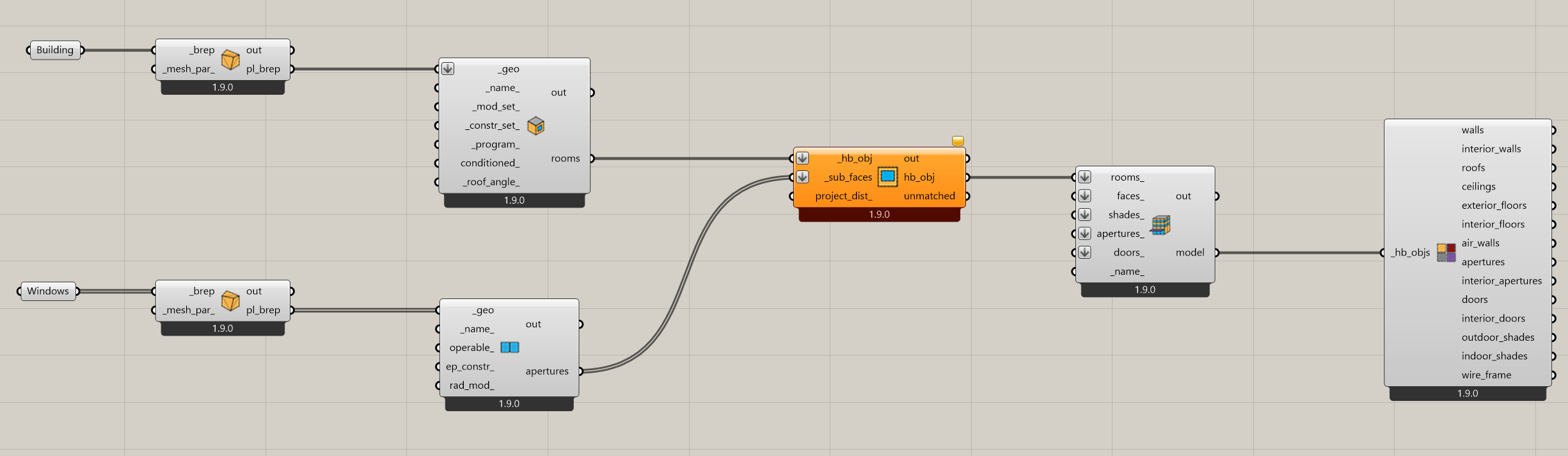

Hello @LostHopper
  1. You can use any visualize type that can give you geometry from HB string.
  2. Yes, please use native GH components for the workflow logic to be applicable for similar parametric geometries.
Its quiet a challenging one but interesting too.
I am attaching workflow image in a zip file
fig01.zip (1.2 MB)
for reference to others.
