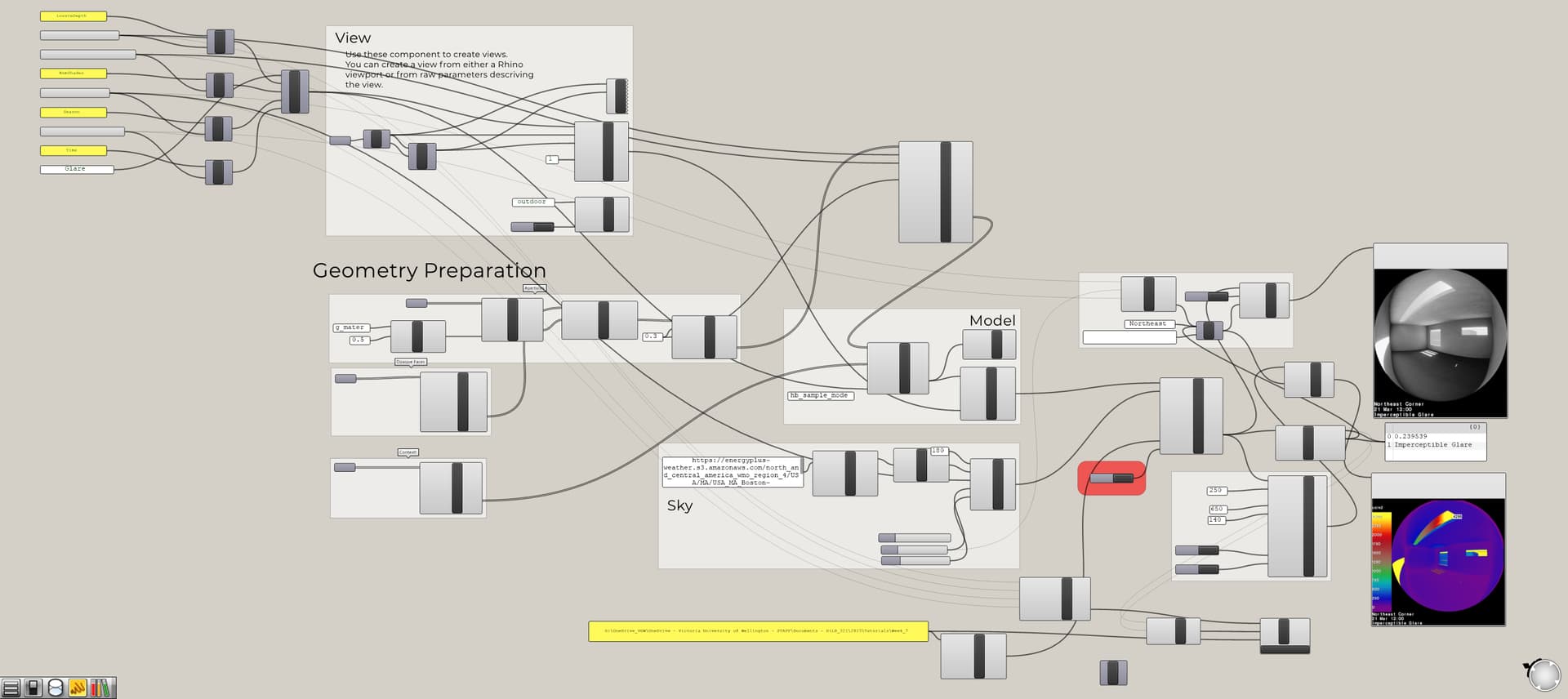

I am looking to adapt the PIT View Sample file “viewbased”.
I want to combine it with the Fly component to produce a series of images of design options.

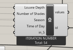

To test the process, I have attached 3 louvre options to the Fly input, and generated automated names via .

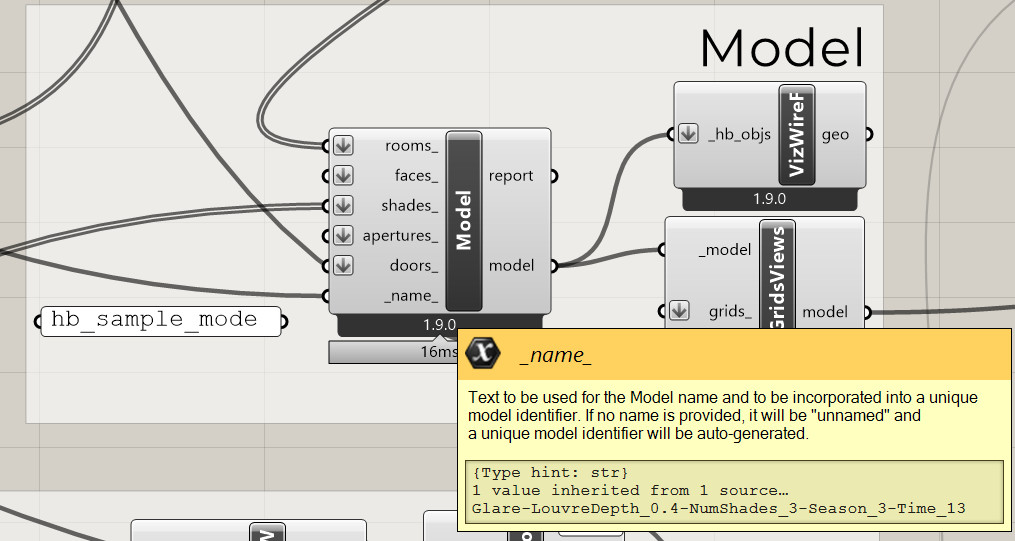

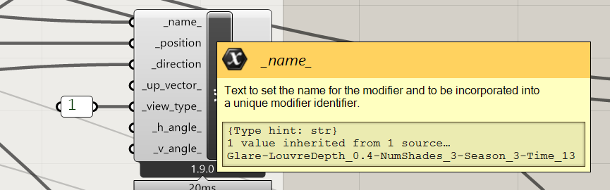

I have tried setting up the name of the view to change with each Fly iteration.
AND
I have tried to set up the name of the Model to change with each Fly iteration.
Neither work to produce a set of test images.

Some challenge here.
See attached file. I simplified it [only one space, only changing the window border depth and low settings for speed]. See the orange groups.
Basically you need to save each option in a different folder. Otherwise, each will override the previous one.
In the attached I am saving only the images as gif files, all of them in the same directory. You have the option to delete [or not] the simulation folders.
You need to provide the simulation folder under all cases will be simulated [subfolders].
I find this useful for myself, hopefully you too.
PoinInTime_View_FLY_Test.gh (98.6 KB)

fly.gh (125.6 KB)

Your little Python script is very useful.
