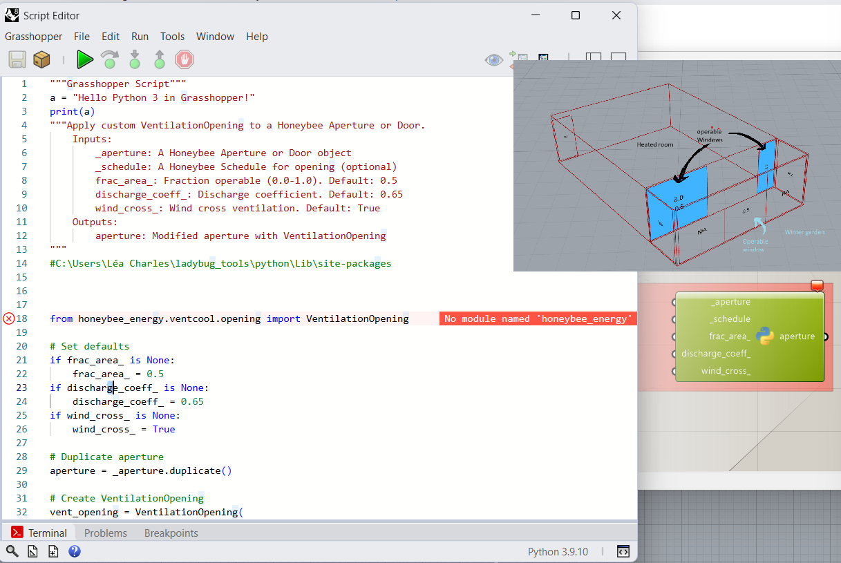

I am currently doing an energy simulation in Honeybee between two thermal zones: a dwelling with an attached winter garden.
My problem concerns the natural ventilation of the winter garden, for which I would like to assign two opening schedules:
  • One for opening to the outside
  • One for opening to the dwelling
This is not possible with the HB Window Opening component.

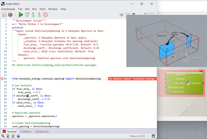

I tried to create a Python code with AI help for natural ventilation management. However, a “No module named honeybee_energy” error appears and I don’t know how to remove it. I have already reinstalled Ladybug Tools but the error persists.
I’m attaching a screenshot of my error and the context of my simulation.
So I’m wondering if anyone has already created a component for Honeybee Energy with a Python script for natural ventilation?
And if so, how could I fix this error?

Hi @Lea ,
Check out this post for details:
but the short version is: you have to use the ‘old’ python, not the ‘new’ python.
all the best,
@edpmay
Hi @edpmay
Thank you for the quick response, I would not have found this solution on my own!
I just tried using the old Python component and retyped the first line to import honeybee_energy, and no error this time. I’m going to try creating my ventilation component and hope that it works.
Thank you very much!
Léa

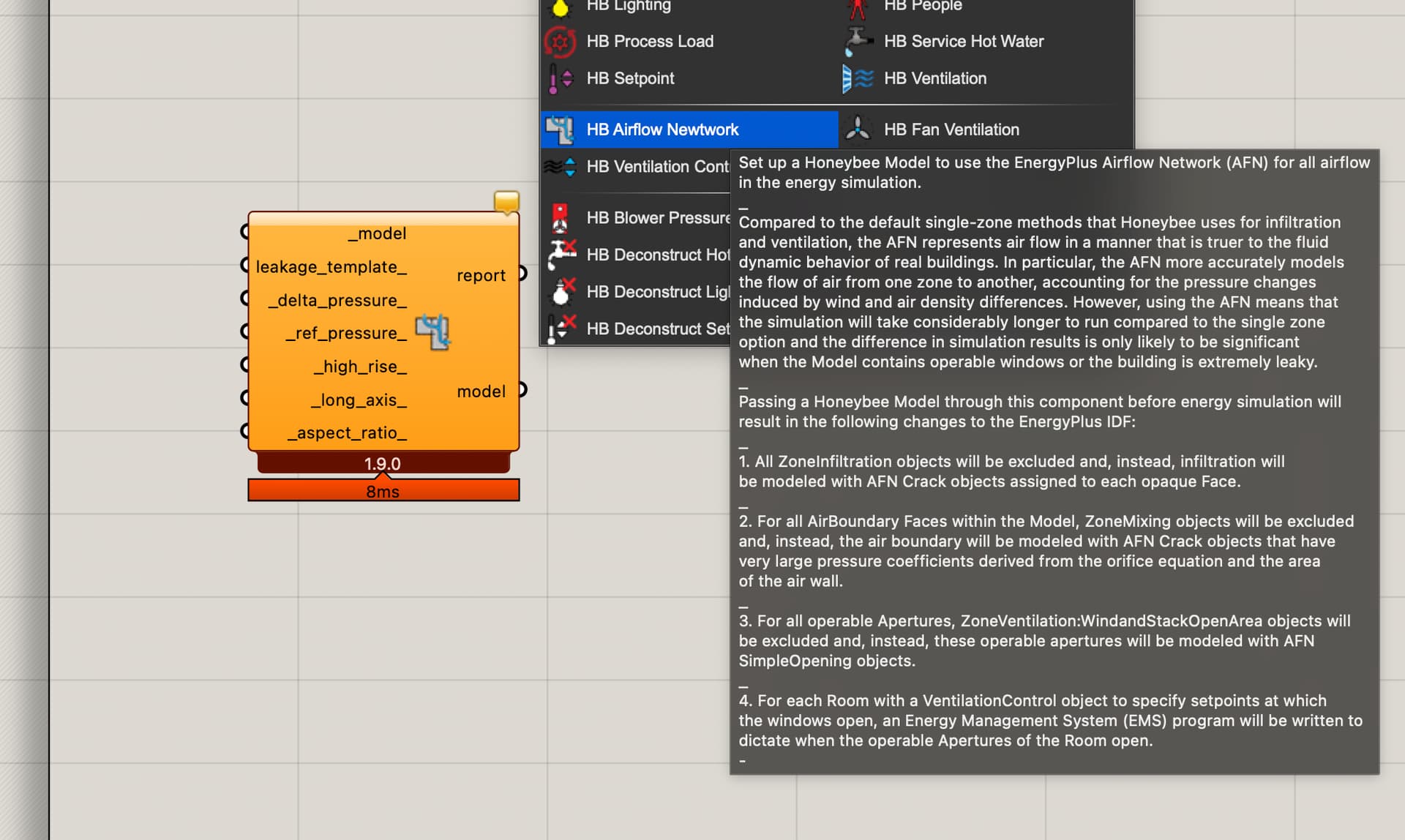

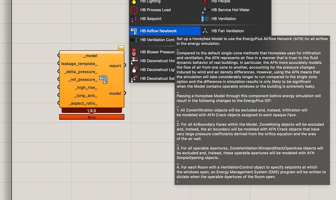

I think that is correct, the room’s window_vent_control applies to all of the windows of that room. It is a room-property, not a window-property.
You might check out the Air Flow Network tools and see if they might help you setup your condition? I am not sure if they would, but might be worth taking a look:
best,
@edpmay
Thank you very much for your advice! I’ll take a look at this component to see if it makes a difference.
Léa
