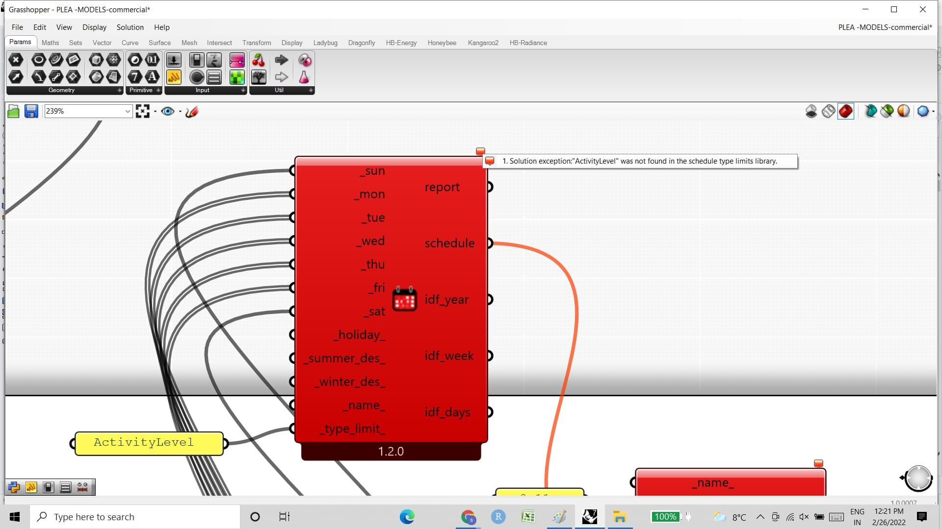

Hi
I installed rhino7 and reinstalled ladybug tools 1.4.0 and I am still having issues with people’s occupancy schedule. It says “activitylevel” is not in schedule type limits. I am not sure what am I doing wrong. Any suggestions??
It would be great if you could share the gh script to check
I have modified you script to make it workable. You were using wrong component to assign schedules. Here is the script
MODEL_Rev.gh (127.3 KB)
Thanks a ton, it was really helpful
