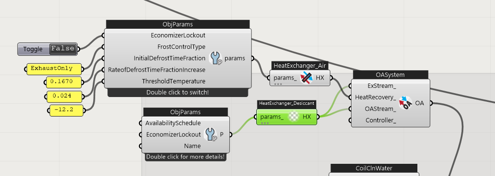

Hi all, I am attempting to set up a number of HVAC templates for design concept testing. I would like to model a desiccant heat exchanger for dehumidification. I have attached it to the OA system as detailed in the screenshot below.
  1. is this the correct way to connect it
  2. is there a way of adding a control to this component inside ironbug?

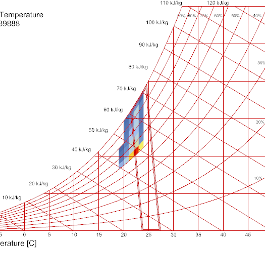

my RH setpoints are 45-55% but i am getting high rh results with the desiccant dehumidifier as modeled above
