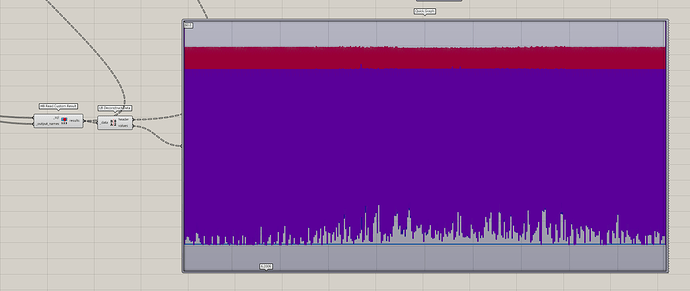

Hey @TrevorFedyna. Just did this! It’s working! The only issue I have is to make the results pop int the Quick Graph component.
@AESB99 In this case you need to deconstruct the data set and feed Quick Graph the raw numerical data. deconstruct data is in ladybug tab.
Hey, @TrevorFedyna It’s working, but does this mean all my variables are in one graph? Is there a way to separate them and have the same amount of graphs as of variables?
Hi @AESB99, if you duplicate the following, and change the index that’s one way to get a graph per dataset
don’t forget deconstruct data.
Hey @TrevorFedyna, I did it. It’s working better, but I steal have a bunch of variables in one graph. Do I have to resplit the list ?

@AESB99 I believe you are right about needing to resplit the list to get single line graphs.
added explode tree to separate the zones results, also added a number slider incase youd rather switch between them at will and save canvas space.
There is probably a more elegant solution, but this is what ive landed on.
Hopefully some of that is helpful

Oh and I had another question related to this topic @TrevorFedyna . Is it possible to have an equivalent of ESOview in GH? But I mean detail wise, like if it’s possible to navigate through the graph and obtain peak values? Cause the way we just did it, we can only see the minimum and maximum, in this case the water temperature.
