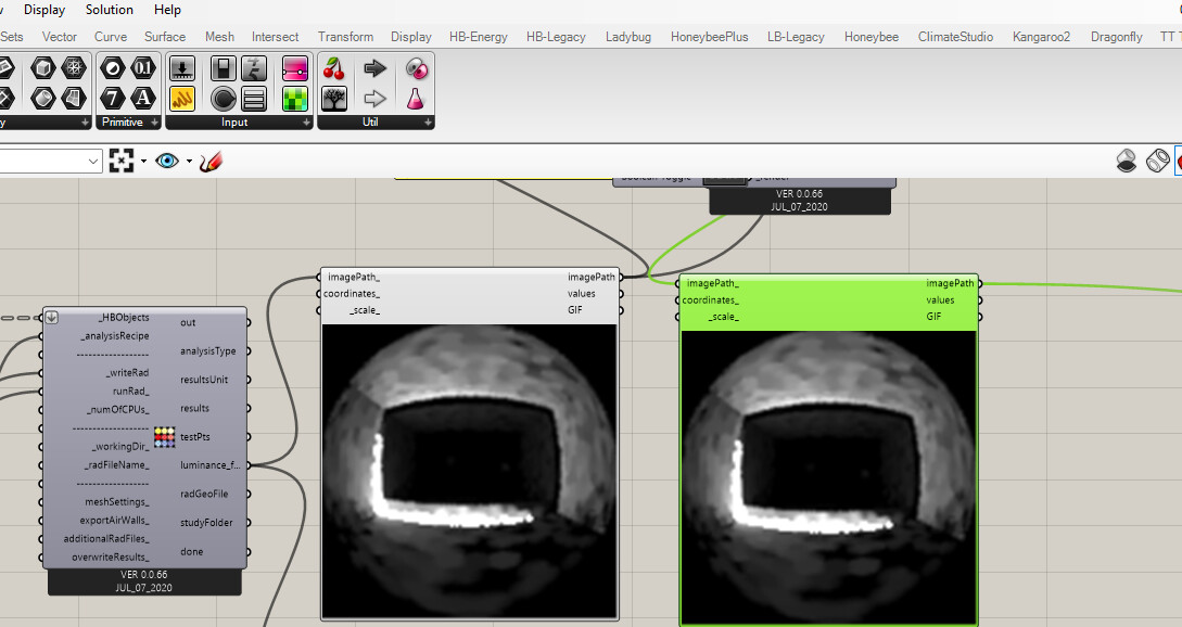

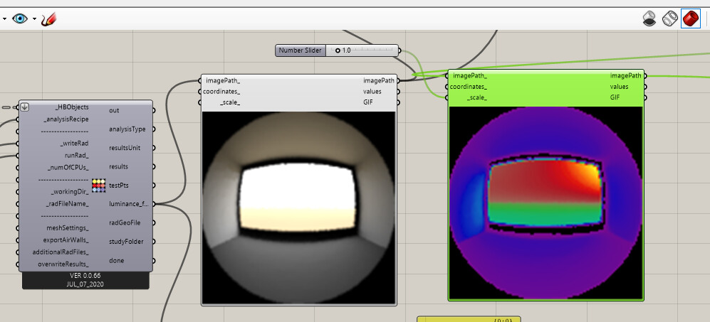

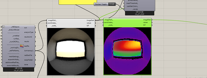

The glass’s visible transmittance in the following images is 0.44, 0.04, and 0.007.
I really appreciate any help you can provide.
This is a radiance render with vt=0.44
This is a vt= 0.04
and this is vt=0.007
