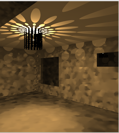

2025-10-30 12_57_37-Grasshopper - viewbased_

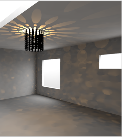

2025-10-30 12_55_19-Grasshopper - viewbased_

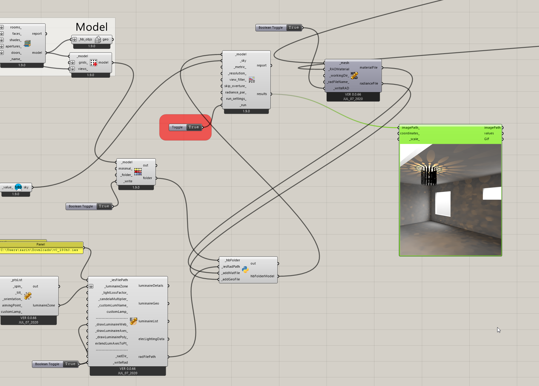

You can choose an illuminance based sky and set the value of illuminance to 0 to create darkness. Then you need to bring in the light fixture definition and any other shapes into the radiance folder. I wrote a script to do that (which is the Python component in the screenshot below: customLBToolsIAddIESComponent.py · GitHub).
The example file I modified to do this was lbt-grasshopper-samples/samples/honeybee-radiance/viewbased.gh at master · ladybug-tools/lbt-grasshopper-samples · GitHub . I forgot to save my modified gh file, or else I would have put that in here too :neutral_face:
