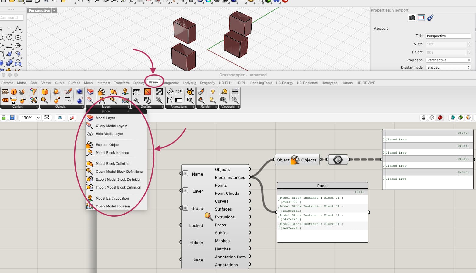

Hi @shay_123
In Grasshopper’s ‘Rhino’ tab there are many components which can be used to reference and work with Blocks. Check the ‘Model’ section in particular:
and the ‘Explode’ component to convert to Breps in GH.

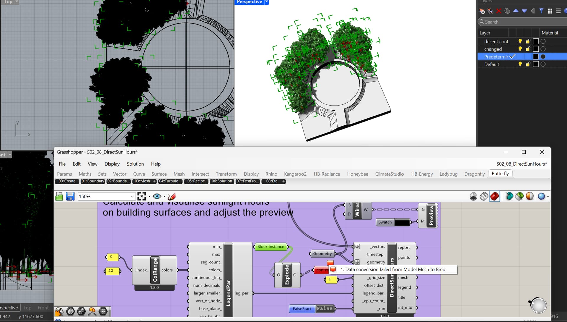

hi im getting this error
Can you provide more information? What is it, what components are you using, what is the geometry you have? what is the ‘context’? There is not much that can be deduced from the info provided, except that it (whatever it is) is expecting breps, but it is getting meshes.

hi im unable to upload the file to this thread but here is the screenshort of the file im using its to find the direct sunlight affecting the site
that is helpful - what is the ‘context’ node that was throwing the error? If you connect a panel to the ‘explode’, what is coming out there?

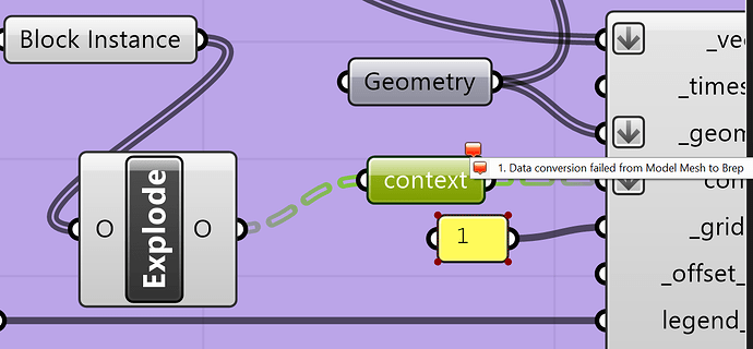

so this the error im getting
gotcha: but what ‘is’ the node that is labeled ‘context’ in your scene? Is it a ‘Geometry’ node? A ‘Brep’ node? A ‘Data’ node?
yes sorry that is a brep node
ah - I see: so in Grasshopper, you cannot pass a Mesh surface into a Brep node. Grasshopper cannot do that sort of conversion.
You should just pass the Mesh directly to the Ladybug component’s ‘context_’ input. Or use a ‘Mesh’ node instead, if you still want to have a node of some form there.
