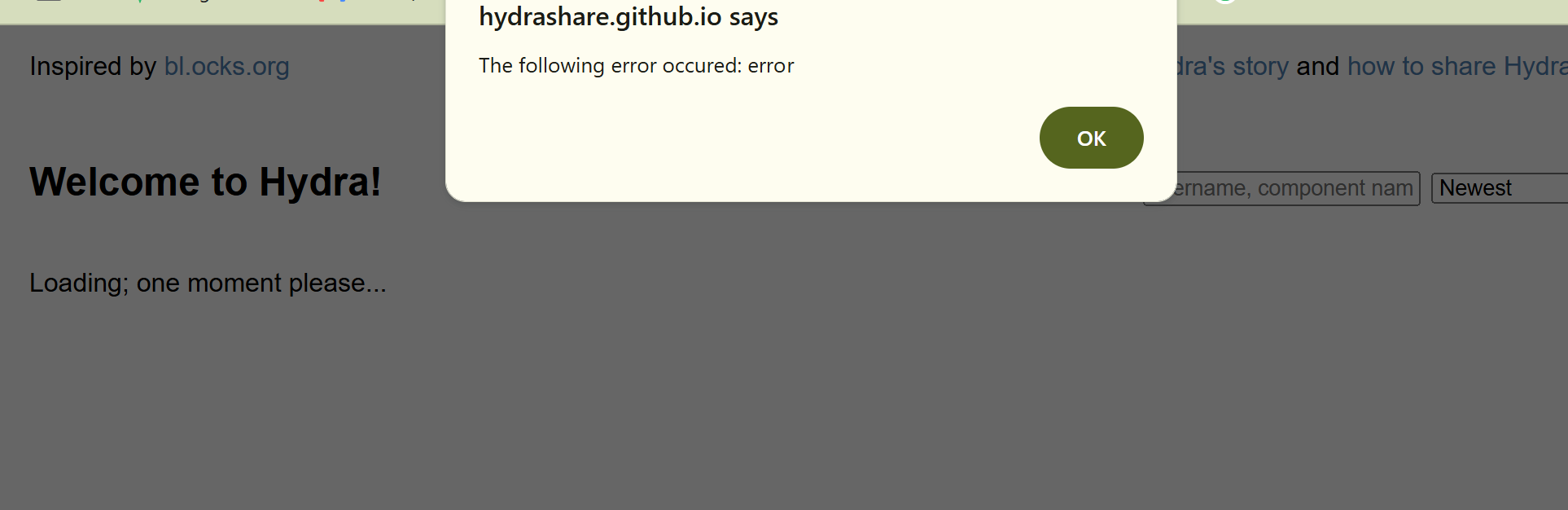

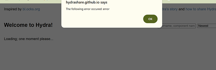

Hello there,
Has anyone else been having trouble accessing Hydra (Hydrashare) recently? I usually use it to find Ladybug and Honeybee example files, but Iโ€™m currently getting an error. Is the site down for everyone?
Thanks in advance.
