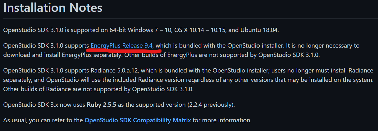

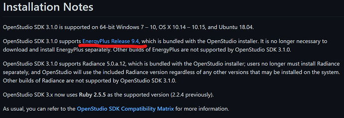

If you follow the link for OpenStudio, it specifies the EnergyPlus version required in its installation notes:
It changes with each few released version, so it’s something to keep in mind for the future.
