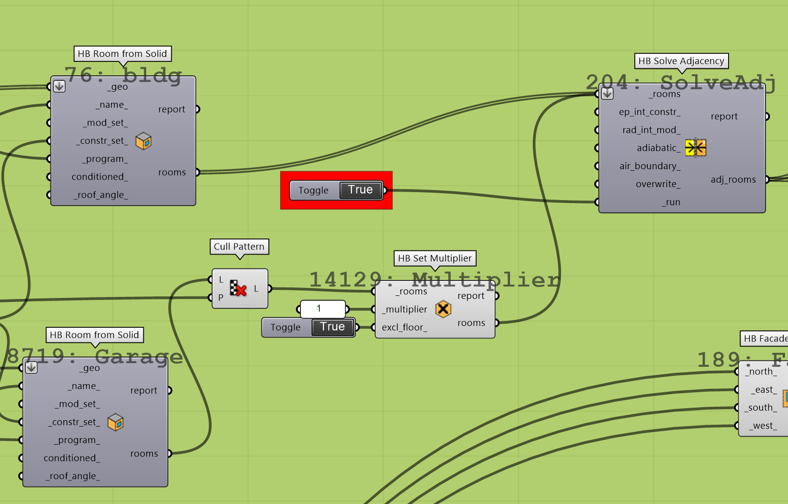

also is this how it should be connected in gh
No, the only way to remove energy use of something in an EnergyPlus simulation is just to remove all lighting, equipment, HVAC, etc. from it. If you want to do this, you can use the HB Plenum component, which removes all internal energy usage of the room while also excluding the room’s floor area from the EUI calculation. This is the way that I recommend things like crawl spaces be modeled.
However, unconditioned and intermittently-occupied spaces like garages still have lights that are connected to the main building meter and therefore contribute to the building’s EUI (even though you do not count their floor area). So the way that I would model a garage is with the Multiplier component and, yes, you have connected it correctly.
thank yu so much chriss this is what i needed! as i am only researching the energy use for heating and cooling loads so this would be perfect.
