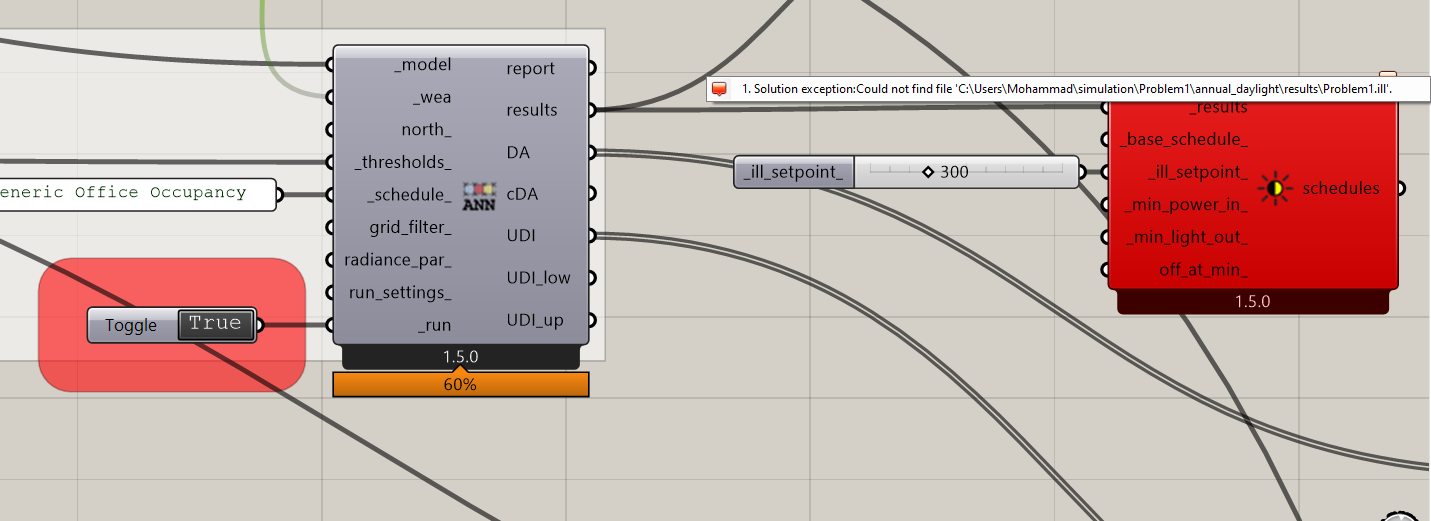

I want to use HB Daylight Control Schedule and create a schedule lighting of daylight simulation, but I get an error. .ill file isn’t in this path. Should I make it manually?
1. Solution exception:Could not find file 'C:\Users\Mohammad\simulation\Problem1\annual_daylight\results\Problem1.ill'.
Best regards
Mohammad
Thanks for reporting, @Mohammad.hakim.a . This one must have slipped through the cracks when we updated that annual daylight recipe to use more efficient numpy files instead of test files. Thanks to the fast work of @mikkel , I just merged a fix:
You can get the new component with the LB Versioner in an hour or so.
