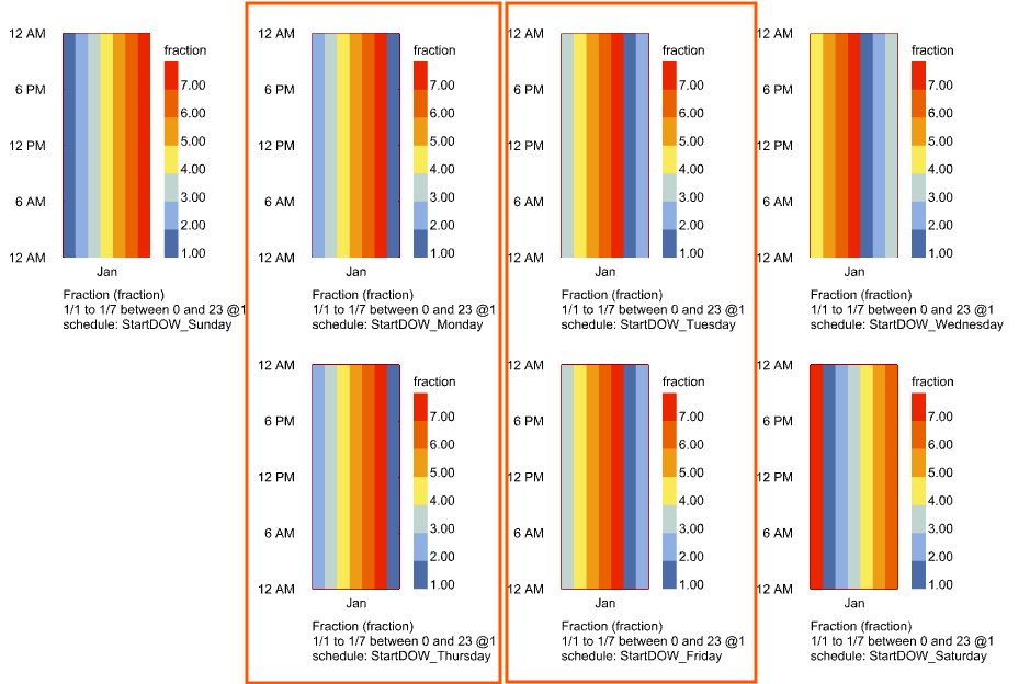

I have just noticed that the week_start_day input in the HB Schedule to Data component has some illogical shifts depending on the day I input. I am using LBT 1.8 but also checked with version 1.10 and it’s the same.
Basically, when I try to shift the schedule, it shifts as expected Sunday-Wednesday, then does an illogical step for Thursday and Friday, then jumps back to an expected Saturday:
Sun - Wed: Shifts as expected
Thu: Same as monday
Fri: Same as tuesday
Sat: Shifts as expected

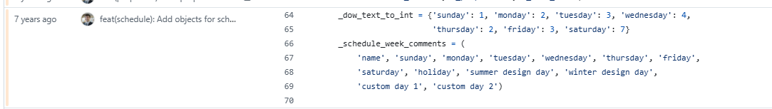

I checked the github repository for the nested functions and I found that in the _dow_test_to_int function, indeed Thursday and Friday is made into the same integers as Monday and Tuesday (2 & 3). I am guessing this a bug, or maybe I am missing something?
I have attached a small sample script, image and screenshot of the _dow_test_to_int function.

Oh, wow. Really good bug hunting, @egerlid.
Thank you for letting me know. This is a bug that has been there from the very first version of the ScheduleRuleset class written 7 years ago:
I’m a little surprised that this typo managed to fly under the radar for so long but I guess this is partly because the bug does not affect anyone’s simulations. It only has an impact on the HB Schedule to Data component like you mentioned.
I just pushed a fix that is now available with the LB Versioner:
Thanks again for reporting the issue and for finding the problem in the source code!
