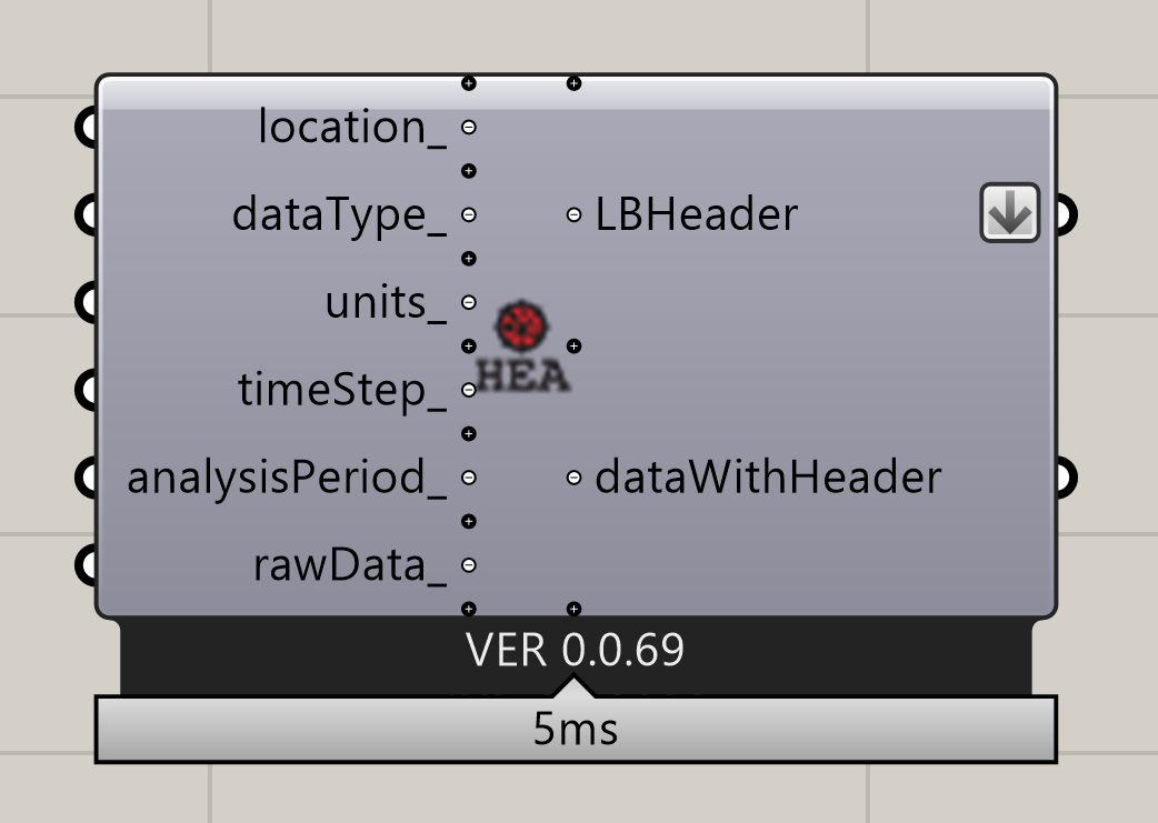

How then do I import the excel data set to hook it into the “rawData_” button of the Create Header tool?
I tried enetering multiline data into a panel but it’ll not take more than 6000 lines.

Is not something i did myself but i would try to create a text file with the data and read it with the native GH read file component.
@AbrahamYezioro thank you.
I finally opened with GH tool “Read File”. It reads .txt

Why do you need to use the panel? You can directly connect the data to the component.
I would save it as a csv file and use read file to import them to Grasshopper. It’s much more straight forward and easier to get you started.
Hello @Mostapha Good to hear from you. Yes, I used Read File and managed to get the data. Thanks so much for this and all your the wonderful work!
