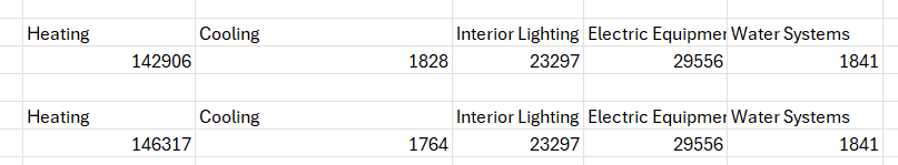

I am running a simple EUI energy simulation for an entire building and I’ve run into a problem: every time I restart Rhino&GH and rerun the simulation, I get different results. But if I do NOT restart Rhino and simply rerun the simulation, the result stays consistent.
For example, here are some results I got from two runs (after restarting Rhino and rerunning the simulations):
This project has some complexity in the program and construction settings, but to demonstrate the issue I set everything to fixed values. So in theory, there shouldn’t be any room for inconsistencies…

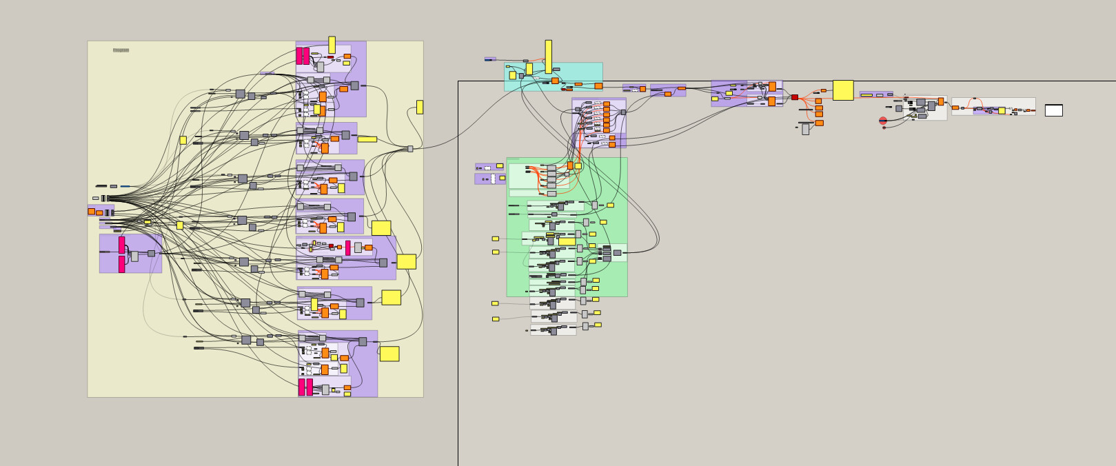

You have too much going on in this script for it to be understandable to someone else:
There’s always a chance that I am wrong but I am willing to bet that the reason why you have not been able to figure out why your script does not run in a predictable manner is because of this.

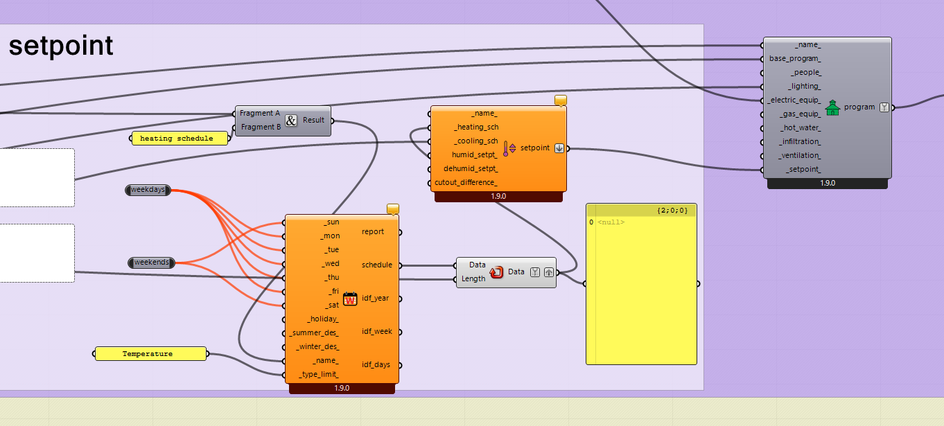

The reasons @TrevorFedyna cited can explain some slight variation in E+ results but the variation that you have in your results is very likely from something else going on in your Grasshopper script - like mismanaged data trees or incorrect duplication of things like what I see here with repeat data:
I recommend simplifying your script and using components under the Visualize section to QAQC what is actually being assigned to your Honeybee objects in the script.
