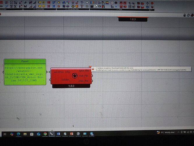

Installation error for latest version
there is strange error when installing. my rhino version is 8.12
doses anyone know where this error rise up from?
Hi @Aliarch the error shows your machine doesn’t have access to Google’s storage server. Please make sure you have a proper internet connection. I’d also suggest you use Pollination’s Grasshopper installer which installs all LBT correctly without internet.

yes i installed by pollination but solving this error is important for me. however i checked my internet connection several times and it was strong.
does it depend on the type of default browser?
No it does not. From the message, it seems like you are working in a location that has blocked access to Google domains (eg. China). You would need a VPN to get around it.
Or you could just use the Pollination installer as Mingbo suggests. That’s definitely a more reliable installation pathway.
for downloading epw by the link, this error is persisted as well
anyone knows a solution?

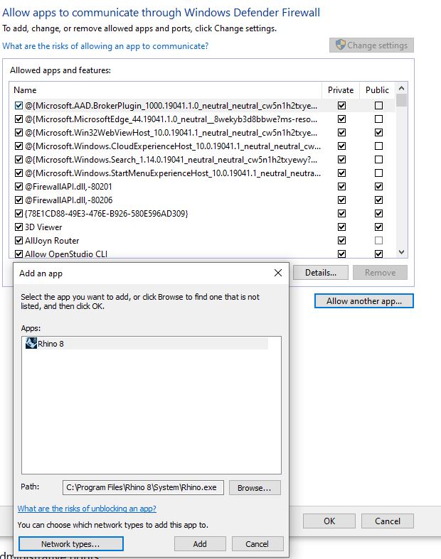

also the rhino allowed to communicate through windows defender firewall
