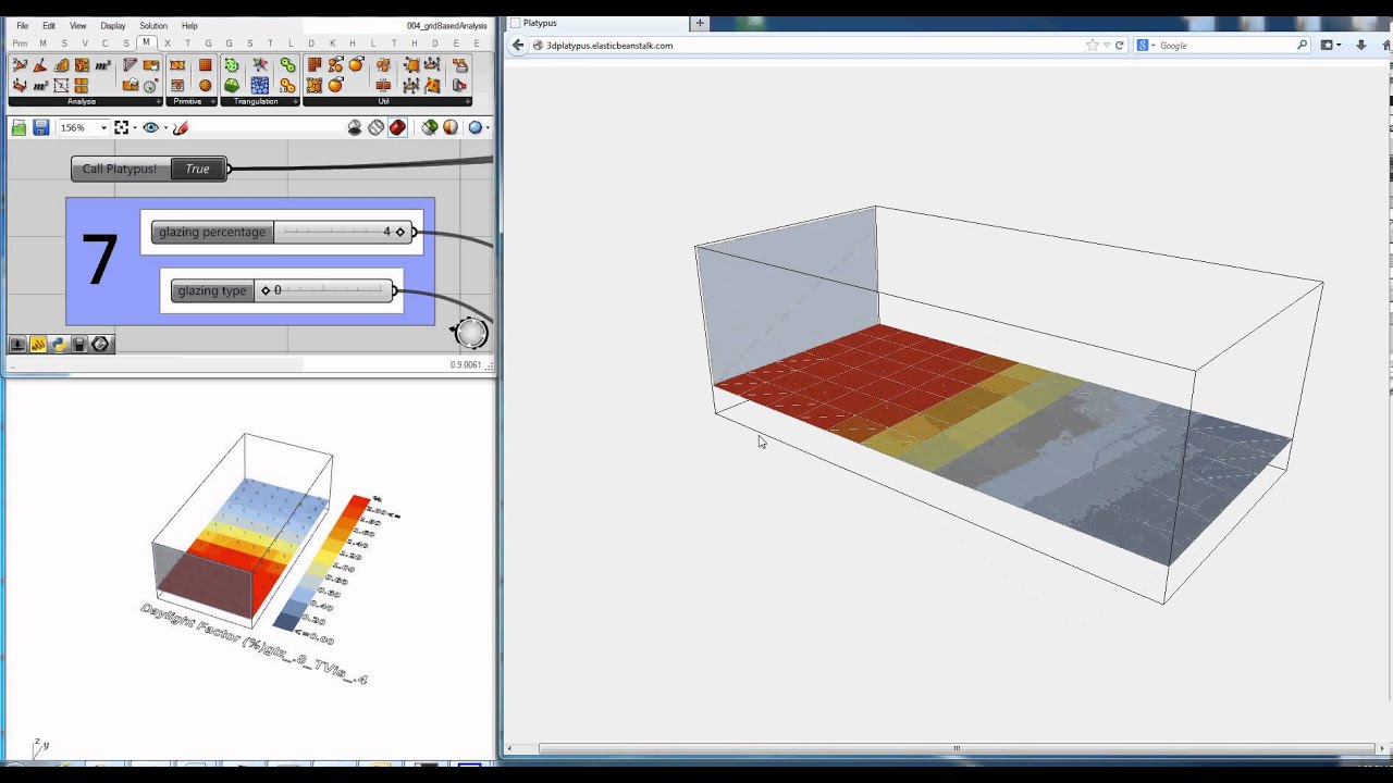

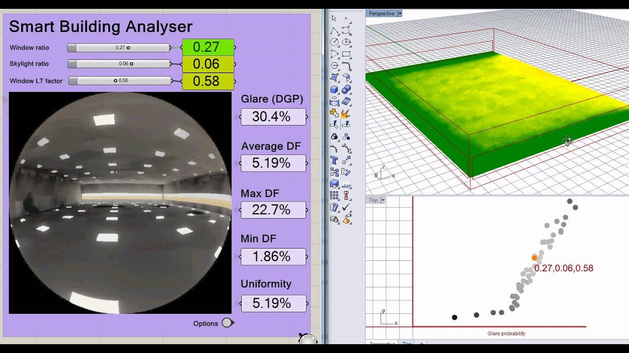

I am doing a assignment of daylight at the university and I saw these YouTube video
What are pretty interesting. Does someone know how to create that workflow?
Thanks in advance
Thanks in advance
Hi @albertomorales,
If you run simulations for all combinations of window ratio, skylight ratio, and glazing transmittance you can create your own database of results (HDR images, DGP and DF). You can then set up sliders that load the results of the slider values by joining folder and file names with native Grasshopper components. E.g., for a simulation with window ratio = 0.3, skylight ratio = 0.05, glazing transmittance = 0.5, you could name the simulation 0.3_0.05_0.5 and then look up the results in the folder of that simulation.
