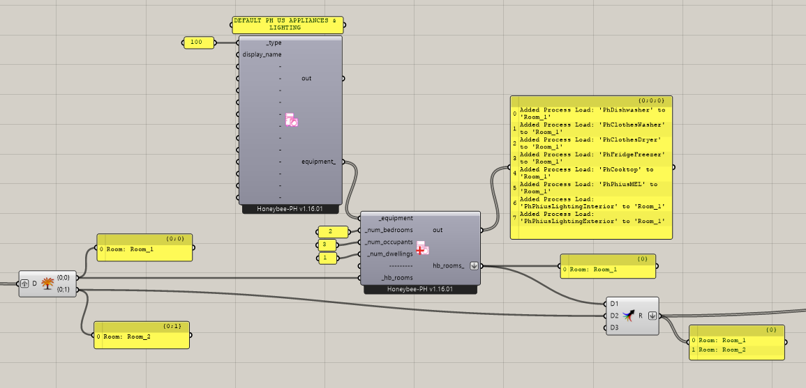

Hey @edpmay I’ve been following along with the HBPH tutorials and now stuck at the occupancy and appliances. I understand the workflow changed slightly since the video came out, but I cant seem to get the internal loads to show up in WUFI. Tried testing out an individual appliance vs the US default and neither worked.

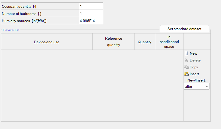

Hey @edpmay , thanks for looking into this. When I run your example script I still see no internal load equipment in WUFI. Is it different for you?

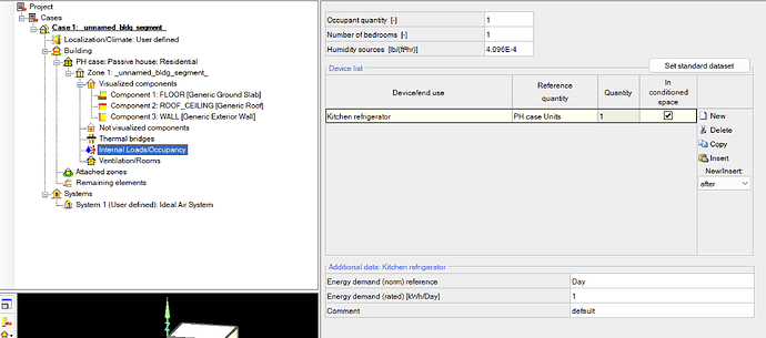

Hmmm… yes that is very odd? yes when I run that sample script, it shows up in WUFI as:
can you send me the HBJSON and the WUFI-XML files that this script produces for you? If you can’t upload them to the forum here, feel free to send them via email to phtools@bldgtyp.com and I’ll be happy to take a look?

I’m using WUFI V3.5.0.1 (free version). I emailed you the HBJSON and WUFI-XML files
WUFI Passive* V3.5.0.1
Just downloaded WUFI Passive V3.6.0.1 - still no internal loads showing up.
