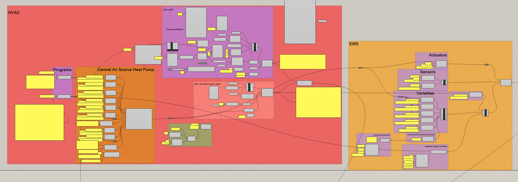

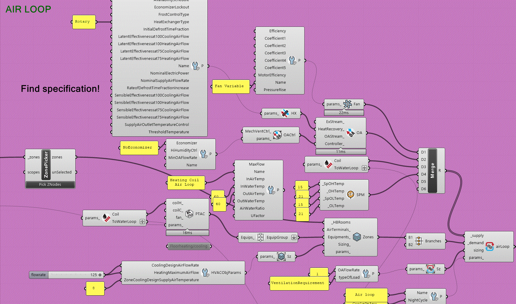

Hi! I’m trying to simulate an HVAC system and I struggle with fixing the errors. I based that script on a file shared by @MingboPeng and I’m trying to understand what are the elements that I have to fix. I’m getting this message: 1. Solution exception: ** Fatal ** Errors found in processing Energy Management System input. Preceding condition causes termination.
I’m a new user so I can’t upload the file, but I’m sending it as a wetransfer. I simplified my original energy model to make it less heavy, so connecting any geometry from Rhino should work. Unique Download Link | WeTransfer
It’s part of my master thesis and I’m running out of time, so I will be very grateful for any tips!

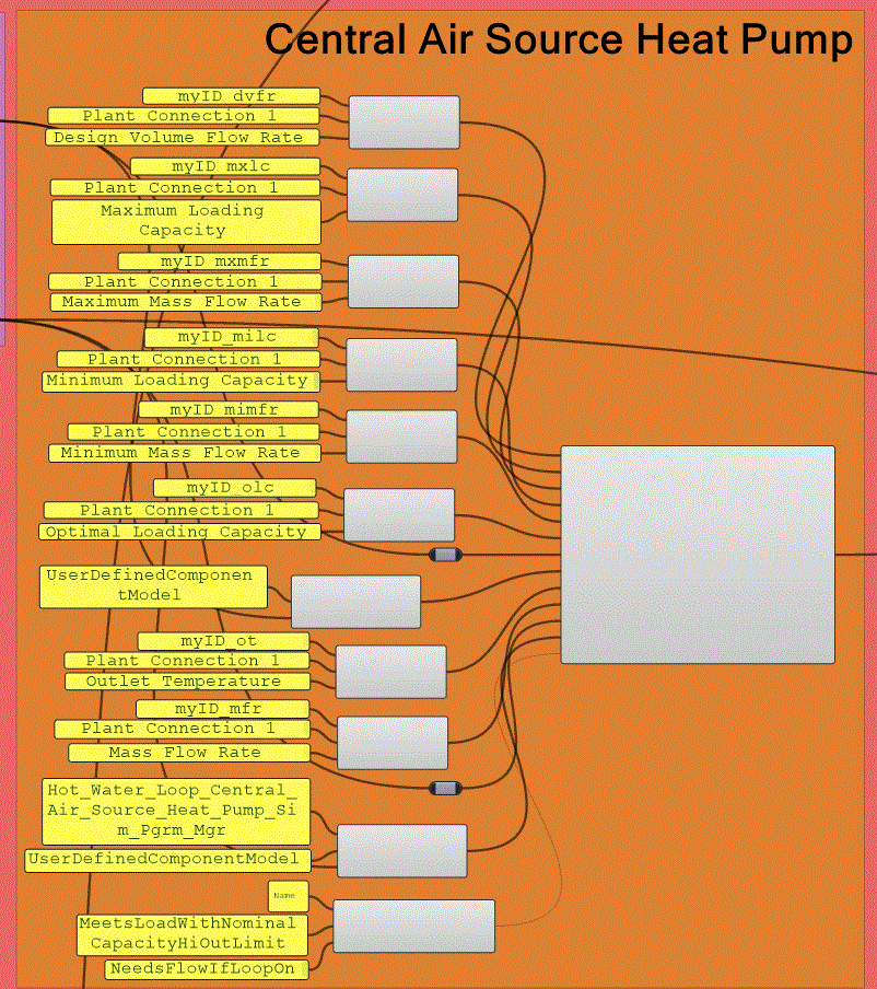

Thank you for a quick response! I’m trying to simulate air to water heat pump and since I don’t have any experience with Iron bug I struggled a lot with finding tutorials how to simulate it. This script that I found on a forum looked suitable for my needs, but I also don’t have knowledge about EMS, so I don’t manage to find the issues. It looks very complicated to me and maybe there is a better way of simulating it?

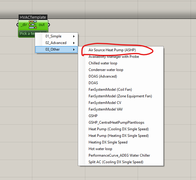

In terms of the system you are trying to model, there is a simpler template you can use for the ASHP.

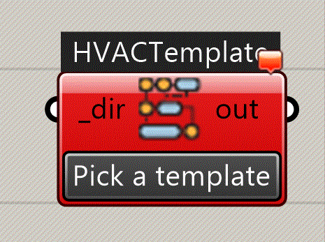

Do you know how can I download those templates? I have tried starting with those at the beginning but I didn’t manage to open them.
The message says: 1. Solution exception: The path has an invalid format.
error

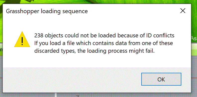

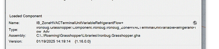

Yes, I did use it, but maybe something didn’t install well since I’m getting this message always while opening GH. I tried to fix it but all the installation files looked fine, so I just left it.

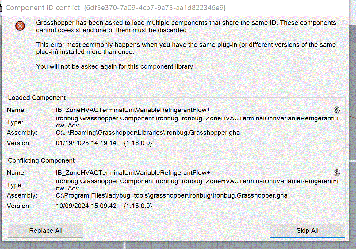

and than I get this one:
Yes, but you also used another way to install it, which is causing your conflict issue. You just need to go to find this location and delete the plugin. You can aslo search the forum how to do it if you don’t know how.
That worked, thank you so much!
