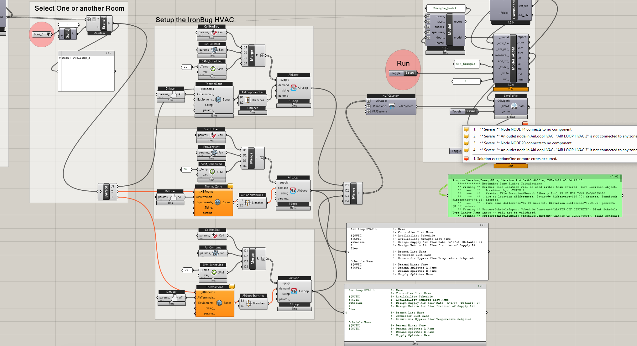

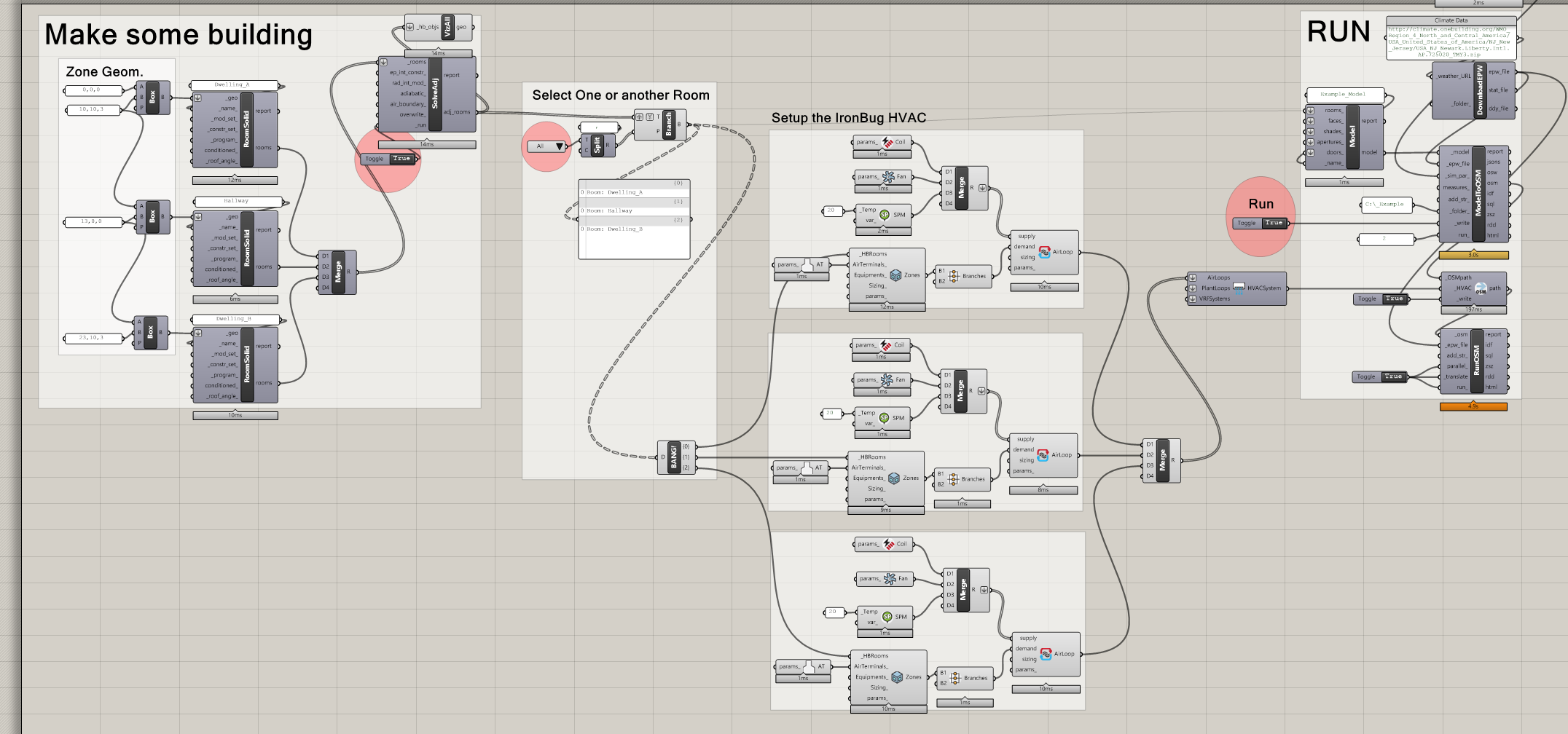

That’s all fine, but the one thing that makes that hard with IB is that the AirLoopHVAC component outputs a default loop, even with its getting ‘None’ as input on the demand side. For instance, if I have simple multi-zone model, and I break out the zones and apply IB systems, that all works good if I am running all the zones:
But if I want to isolate just one or another zone (just temporarily for testing while working / building the systems), then the AirLoopHVAC components still try and output their data, even though they are getting ‘none’ for their demand-side input:
So then in that case, of course I get a ‘Node Error’ since those rooms/zones aren’t included. I have some workarounds that can help manage this of course - and its not a huge deal - but if it was possible to just get the AirLoopHVAC to output ‘None’ until it is getting valid demand-side input, that would really help simplify / streamline in this particular use-case? It would really help to make ‘chunking’ the model for QA/QC work a lot easier I think.
