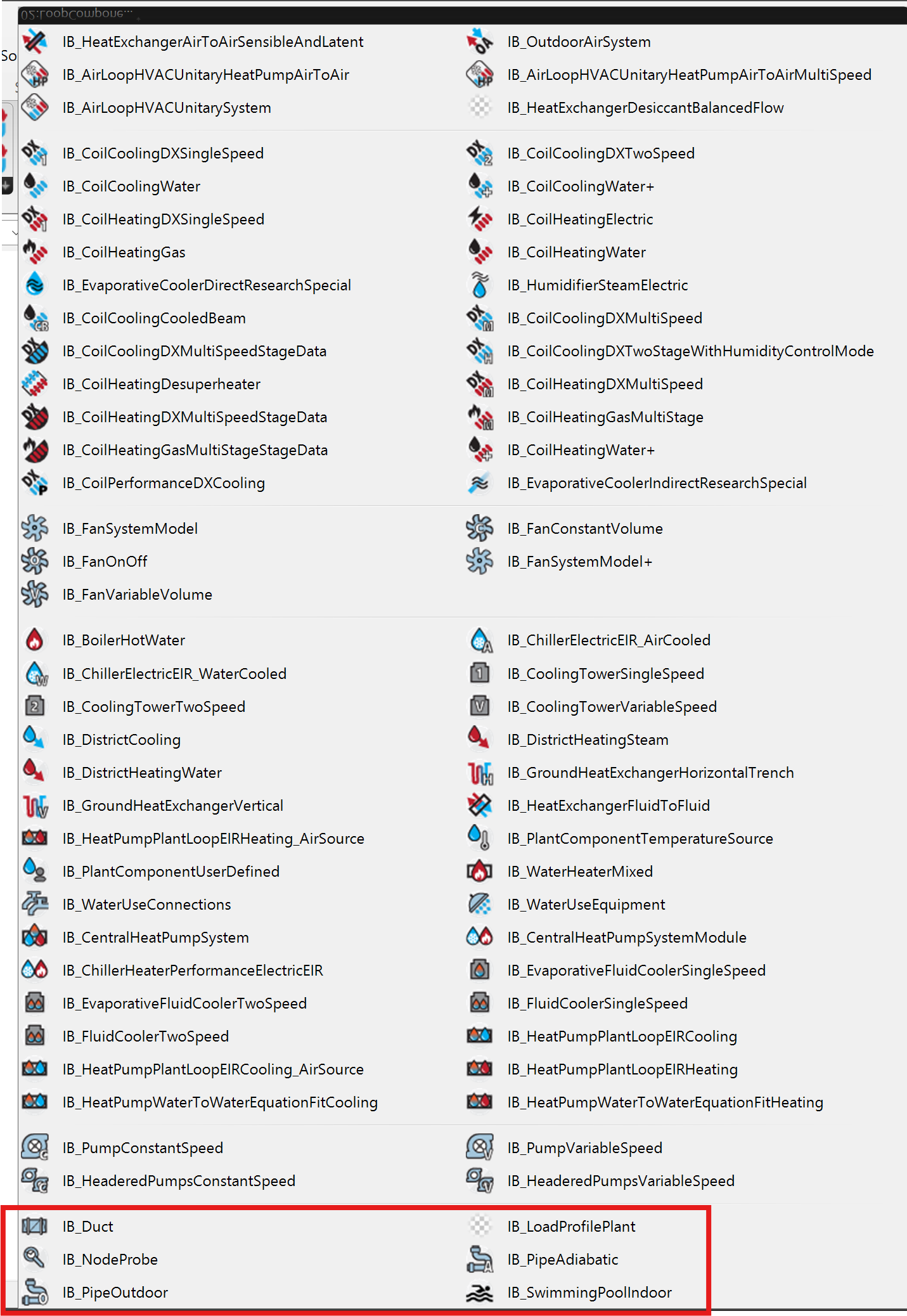

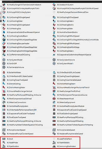

I’m looking for the Pipe:Indoor equivalent in Ironbug, but I fail to find it (outdoor and adiabatic options are in the loop component objects):

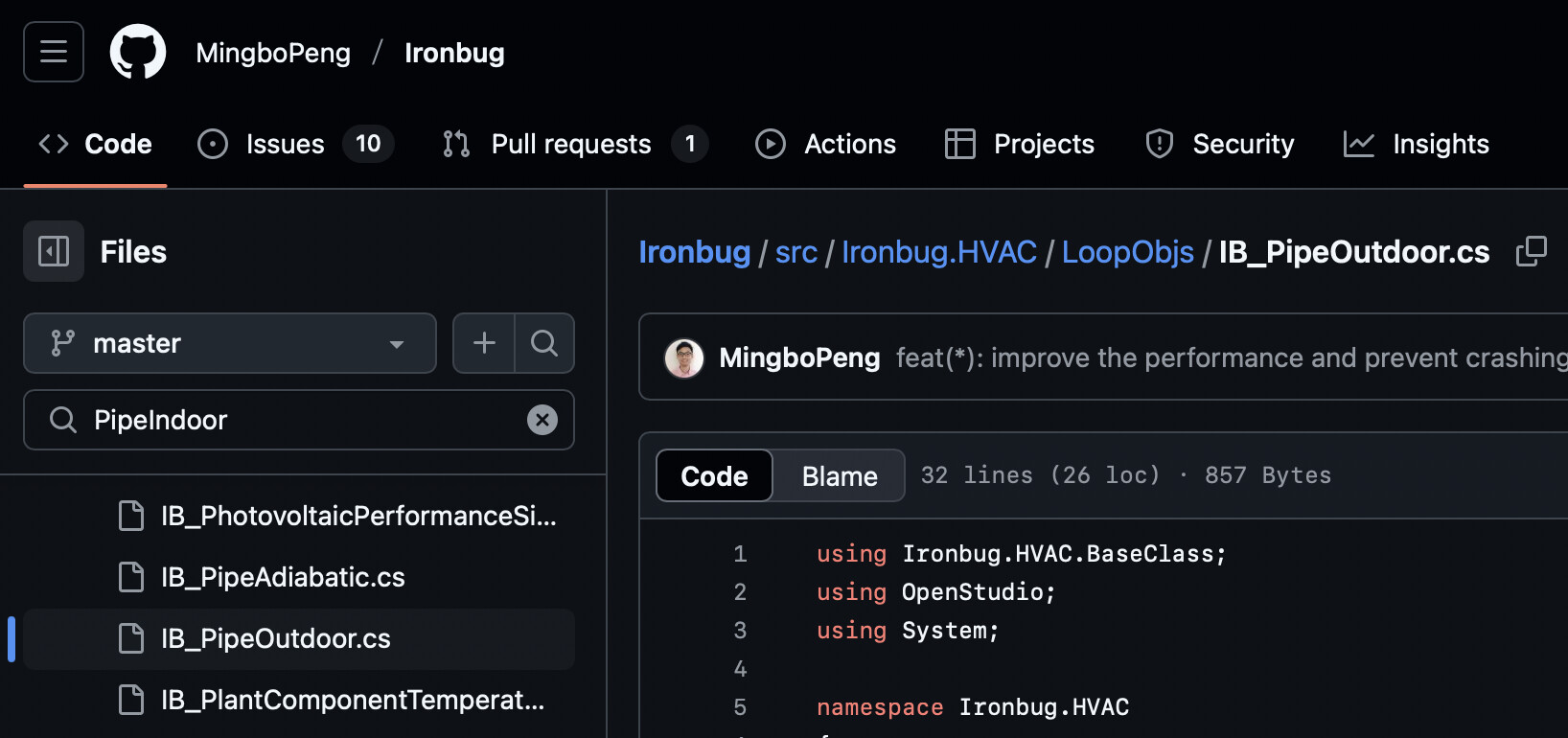

I’ve looked at the Github repo and couldn’t find the source for it either (it has icons though):

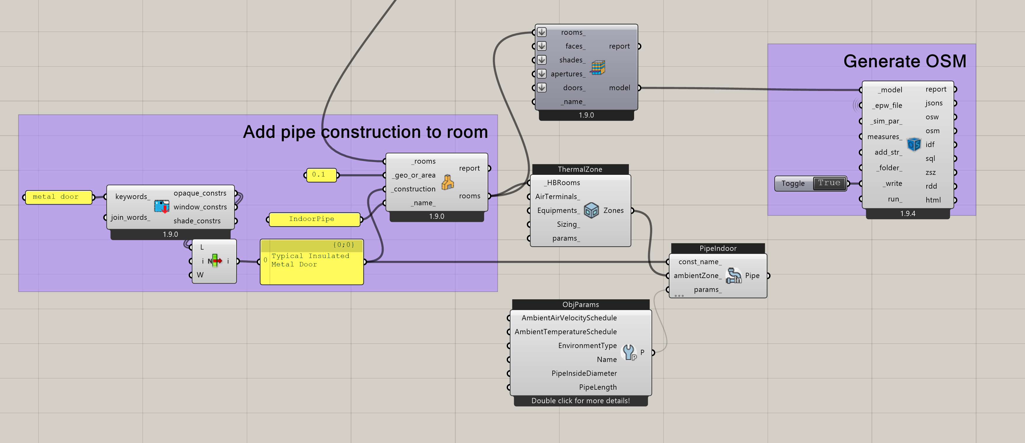

Hi @furtonb sorry for the late reply. I just added the new PipeIndoor and here is a sample file:
pipe_indoor.gh (54.7 KB)
It will be in the next version of Ironbug release.
