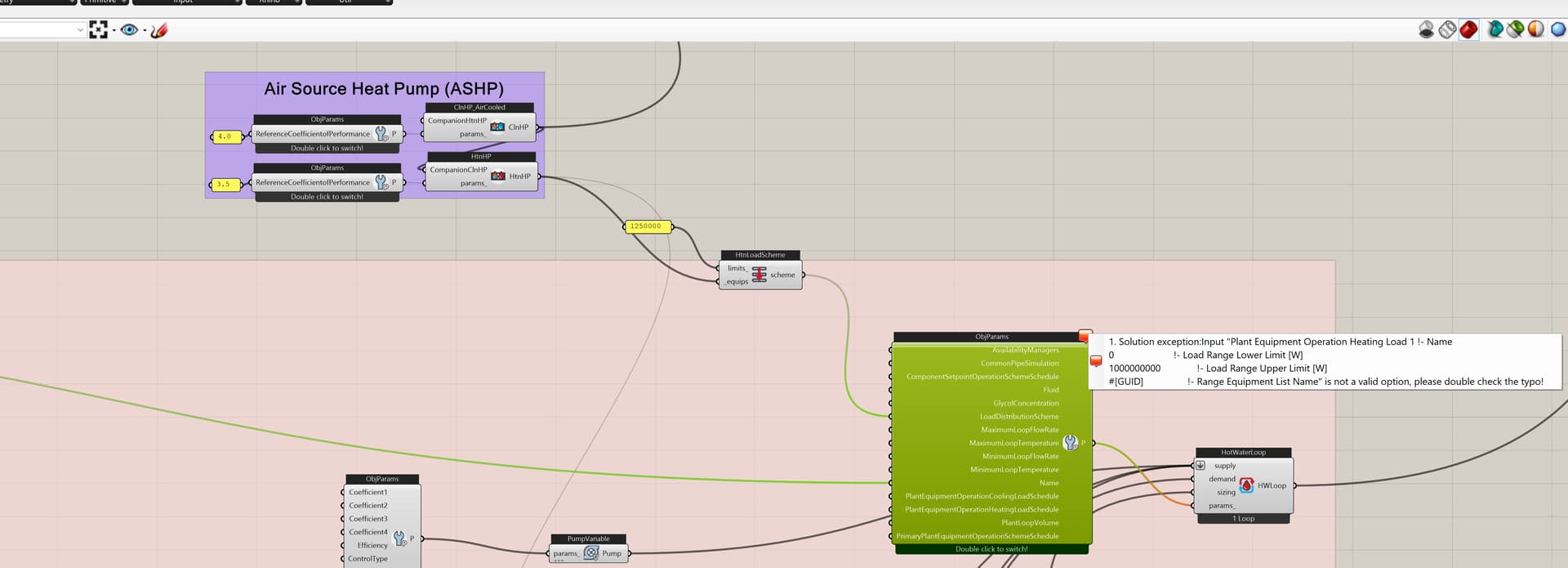

Hello All - I’m trying to build a heating plant loop with a boiler and an air source heat pump. I am trying to use the HtnLoadScheme component to organize priority of systems.I tried hooking up as shown in screenshot and I am getting an error in the plant ObjParams component, any ideas what might be happening?
I often get these energy plus naming errors when there is a component that is not where energy plus would expect it to be because of the way it is put together in ironbug. Sometimes it has nothing to do with the component named in the error. Often I solve them by simplifying the system to triangulate the component causing the error
Thanks for the suggestion! How exactly do you triangulate the component? Are you somehow extracting the GUID or something like that?
Usually by going through the energyplus documentation on bigladder and/or viewing the generated OSM file in OpenStudio to visualise the loop systems with node names. Ive not come across this particular issue before so I can’t be of more help than that sorry!
