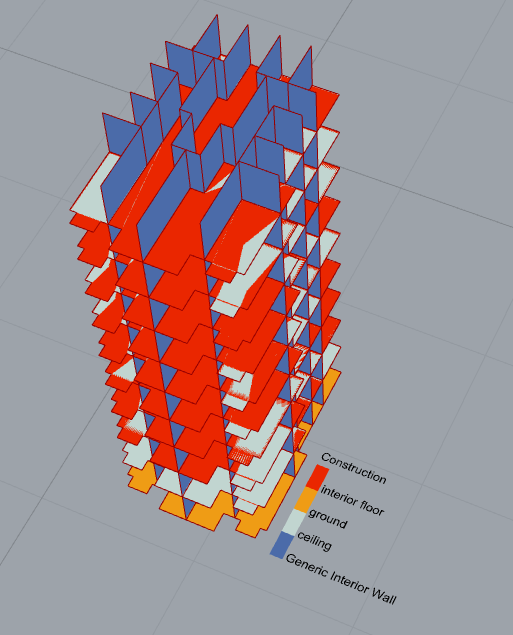

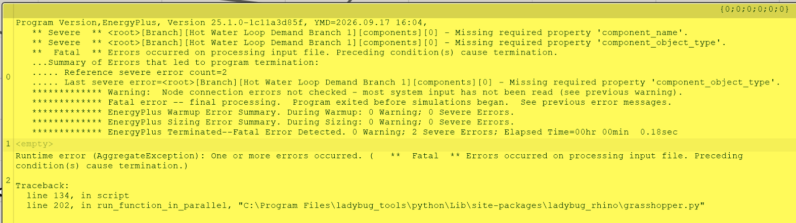

Hello! I have applied the construction for “INTERNAL SOURCE”, and have checked the construction attribute of the surface and ground. then use the rooms for creating an HB Model. But always receive the error message as follows. I can’t ensure where the problem is.
Hi @Makaella I’d post a picture or share the file containing the ironbug script for better troubleshooting
