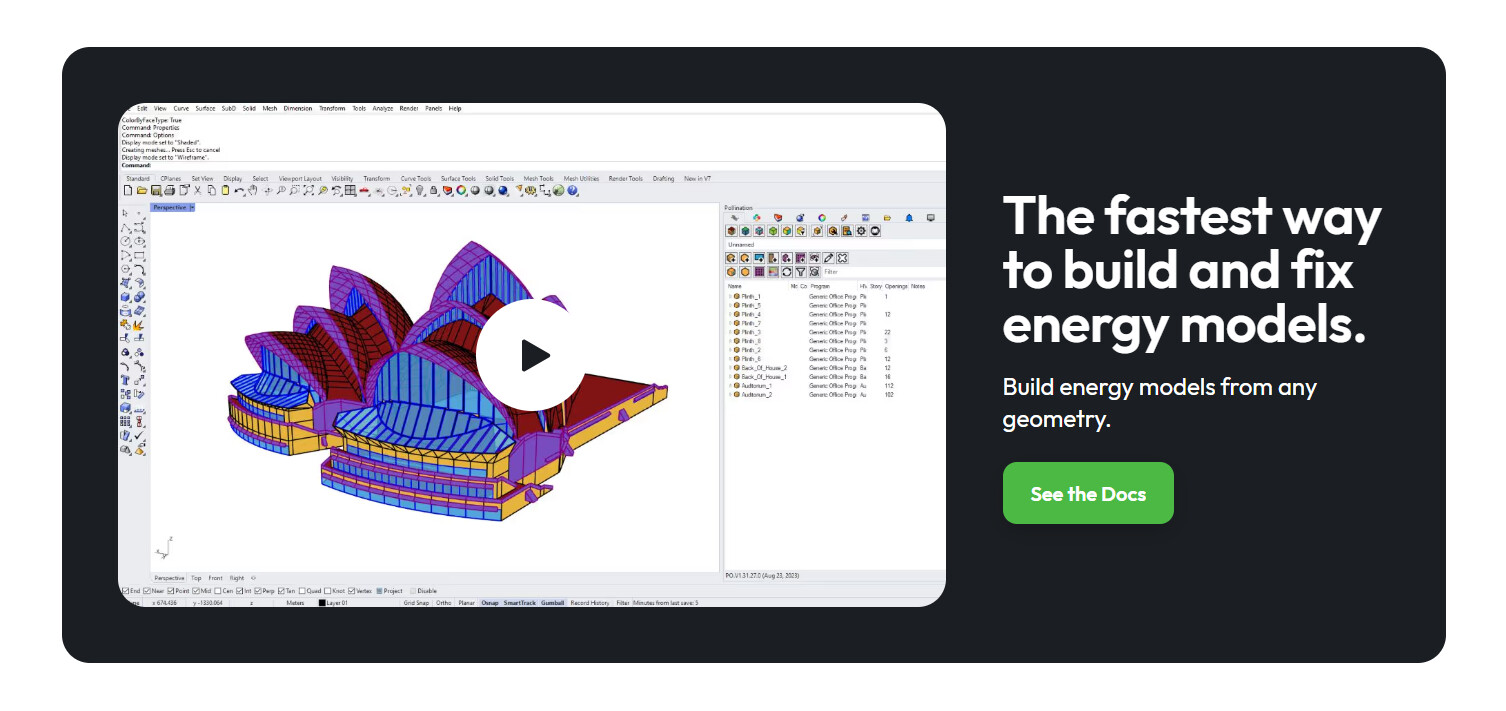

That’s not true @AESB99 , pollination rhino can also do energy model geometry processing:
Getting Started in Rhino | Pollination Docs

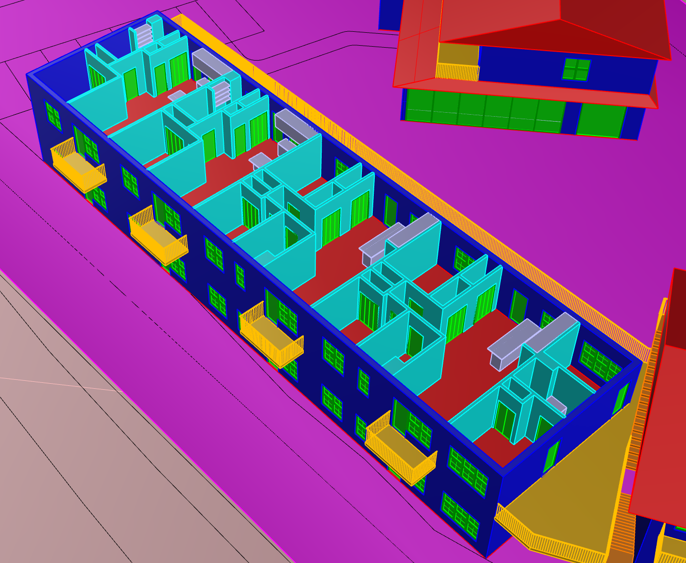

Oh thank you for this info @remyweather . Forgive my ignorance, it’s the first time I use this flow work and when I opened it for the first time I only saw this (see picture). And thank you for the video, it has been very helpful :slight_smile:
No problem @AESB99 ! I think to do the energy model geo processing you will eventually need to pay. the free pollination rhino plugin is just for the enviro analysis, i think. there is a free trial however.
