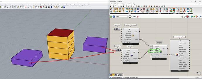

Is there a component that accounts for shading interactions between buildings in HoneyBee?
I recall that the Legacy version had a component called HBContext that handled the effect of one building shading another. I’m wondering if there is an equivalent in the current toolset for HoneyBee
Thank you for your time and assistance.

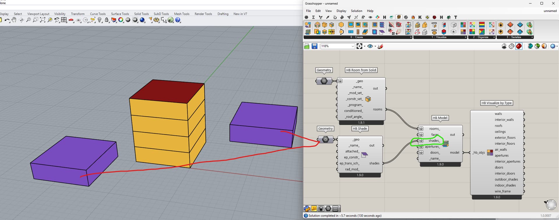

Hi @behnammmohseni, you shouldn’t need a special component for context shade, you can just stick shade objects here and it will be accounted for as context shade in the E+/OS simulation, unless I have misunderstood what you are wanting to do.
