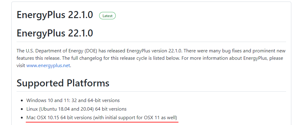

Thanks for letting us know, @MonicaPinto . I guess MacOS must be going through some big changes beyond just the name change from “OSX” to “macOS.” You’re right that I see the last release of EnergyPlus is only partially supported in macOS 11:
… and they don’t even mention macOS 12.
But I can see that there’s macOS 12 support in the latest development version of EnergyPlus that you can find here:
You can give that development version a try, which should at least get the HB Annual Loads component working for you (though not the “Model to OSM” component). In any case, hopefully this means that the next stable release of OpenStudio/E+ happening in the next 2 months will work for you.
