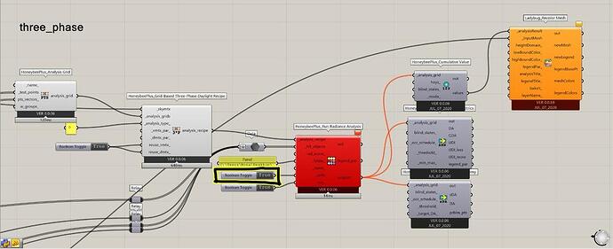

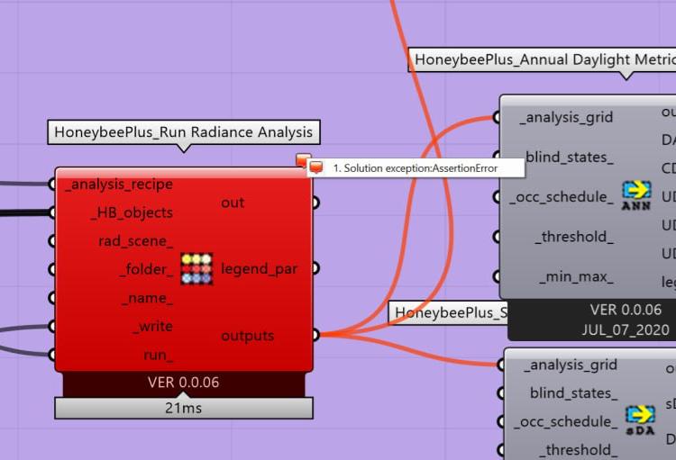

I’m trying to run a Radiance Analysis in HoneybeePlus, but when I execute the 3-phase and 5-phase code, I encounter the following error:
Solution exception: AssertionError
6.gh (678.5 KB)
I’ve attached a screenshot of the error and the component setup.
Hi @Maronaa,
Check this. You need at least one window group with a BSDF modifier.
