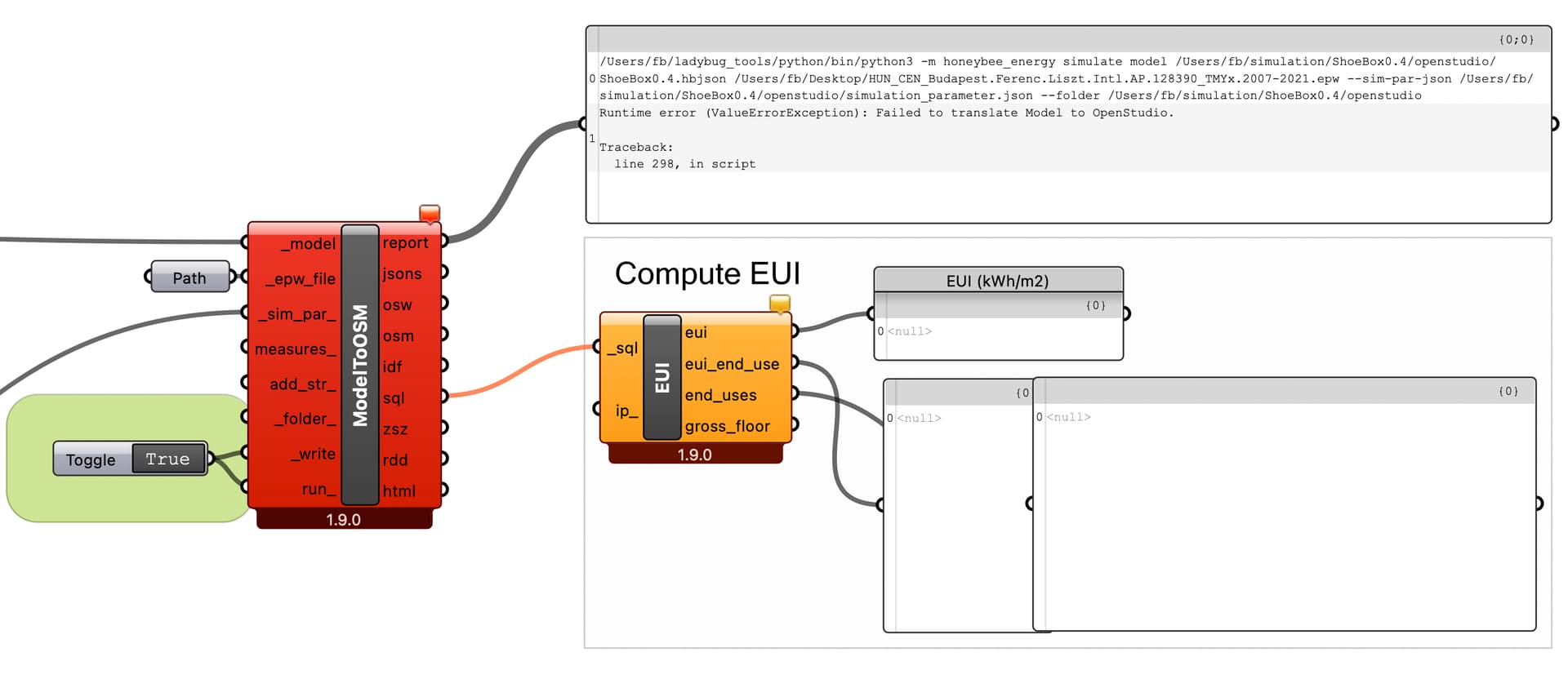

I face another problem, none of the energy models get translated to OpenStudio.
At first I thought it is due to my older scripts which I started updating from 1.8 with no luck.
Then I tried the 1.9 energy samples from the Food4Rhino install folder and all of them raise the Failed to translate Model to OpenStudio error. I came to the conclusion this is a setup issue on my end, that I can’t figure out.
This is the shoebox example :
/Users/fb/ladybug_tools/python/bin/python3 -m honeybee_energy simulate model /Users/fb/simulation/ShoeBox0.4/openstudio/ShoeBox0.4.hbjson /Users/fb/Desktop/HUN_CEN_Budapest.Ferenc.Liszt.Intl.AP.128390_TMYx.2007-2021.epw --sim-par-json /Users/fb/simulation/ShoeBox0.4/openstudio/simulation_parameter.json --folder /Users/fb/simulation/ShoeBox0.4/openstudio
Runtime error (ValueErrorException): Failed to translate Model to OpenStudio.
Traceback:
  line 298, in script
The component creates both the model and simulation paramter JSONs, then stops, the OS Workflow file is not being created. The script section which raises the error:

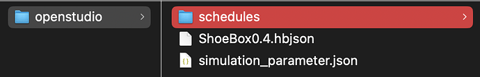

This is the job folder with the resulting JSONs:

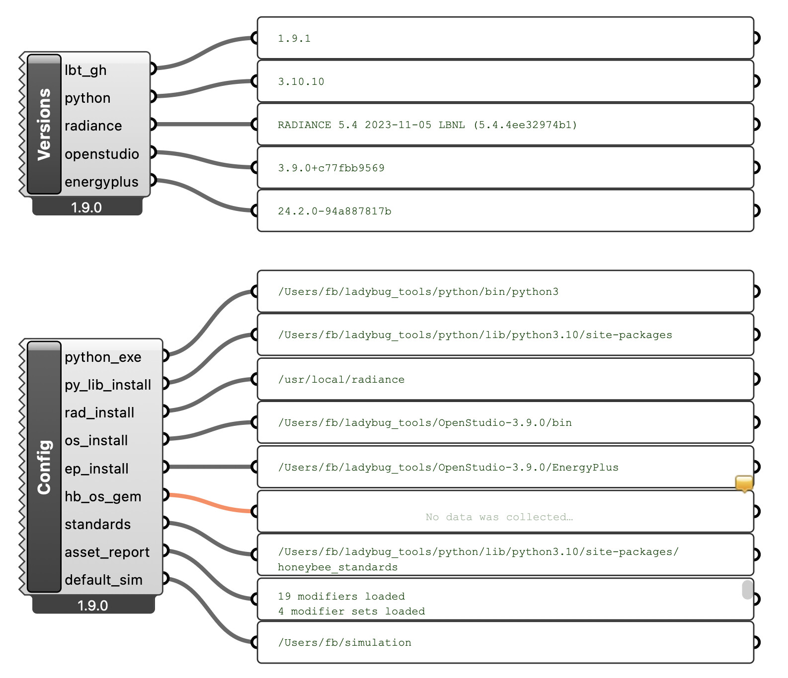

I find this strange as I have all prerequisites installed (and Radiance models are running without a hiccup):
Any ideas what could go wrong? I’m on an Apple Silicon chip and I have Rosetta installed – I did not face issues like this with LBT 1.8 or earlier releases.

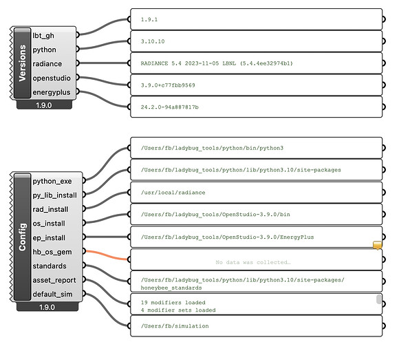

That’s what I missed yesterday when checking the 1.9 samples.
(See the first post in the thread, I was already having 1.9.1.)

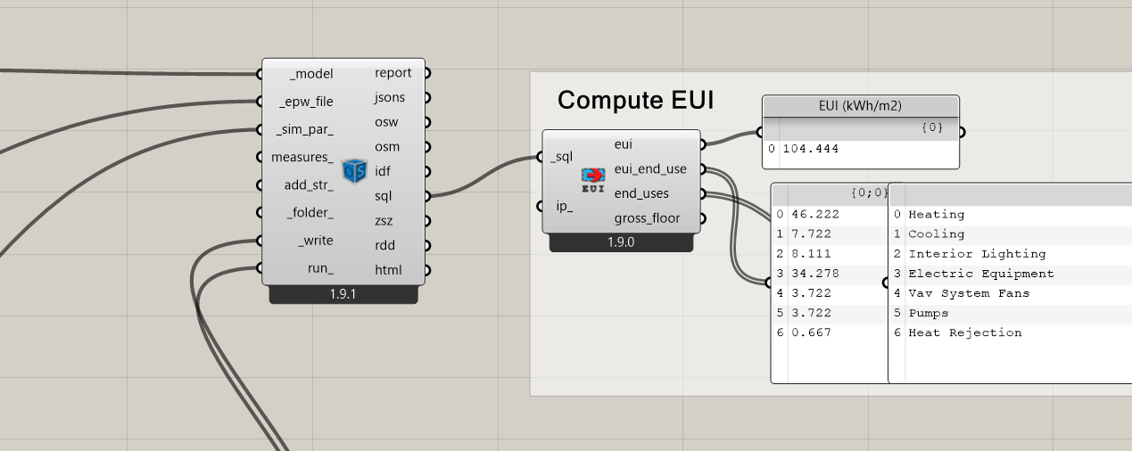

Thanks! :slight_smile:
