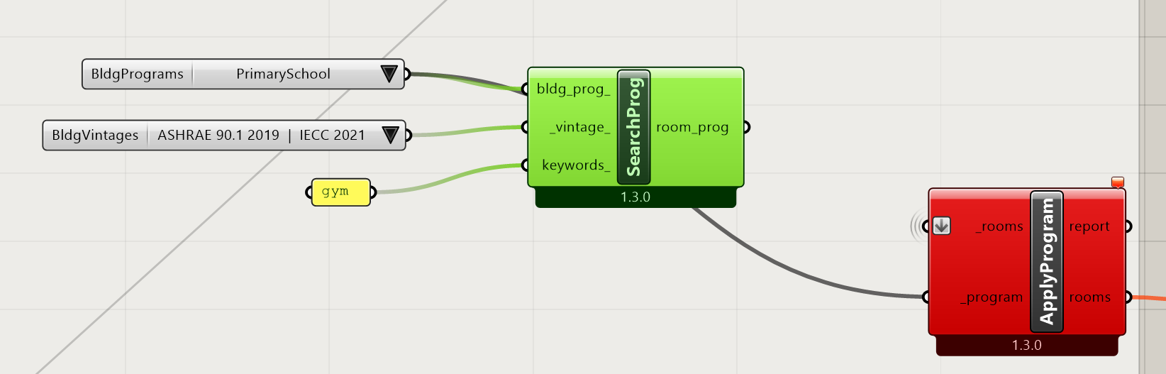

I’m trying to simulate a mixed-used building which includes a fitness facility, for which I was planning to use the “Gym” program from Secondary School with some template modifications (as suggested here).
However I’m having issues when assigning the program to my rooms and get the following message for anything related to Primary and Secondary School programs:
“1. Solution exception:ScheduleRule start_date must come before end_date. 01 Sep comes after 01 Sep.”
I’m using the latest release of LBT. Has anyone experienced anything similar?

I’ve now reopened the file to review the issue again and I don’t get a problem with the Gym schedule anymore but I do get the schedule error when I plug the School program directly… Such a mystery!
Cheers,
Ines
Ah, thank you for clarifying, @ines.idpe . Now I understand. The individual room programs don’t have this type of situation but, when they are blended together to represent a mix for the entire building, then this case of having the same start and end date arises. From my tests, I can see that this situation actually seems to be acceptable according to EnergyPlus and OpenStudio so I just removed this check:
… and now you can apply the blended PrimarySchool program without issues:
