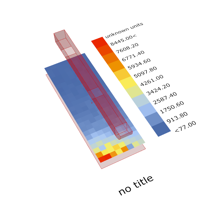

Hi ,
@mikkel
I’ve modeled a horizontal light pipe, but it seems like it’s not being considered in the simulation. Even when I disable the room’s ceiling, the results remain the same. As shown in the attached image, despite having two light entry openings, there’s no impact on the room. It feels like the software doesn’t recognize that the ceiling has a hole and light is coming through. Any suggestions on what I should do?
