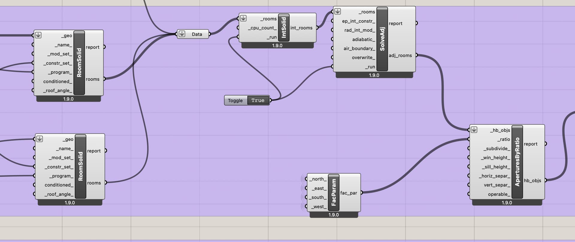

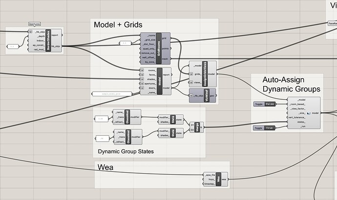

Hi there,
I am wanting to model electrochromic glazing by using the lb sample auto_dynamic_apertures where it switches the VLT of my glazing when it is getting brighter. I noticed that the UDI map results do not change after using this sample, is it because I havent modelled the apertures individiually and are just using the rooms input where I have apertures by ratio that provide apetures for my rooms. Also how do I know at what light level the glazing starts to change states? I have attached images for reference
