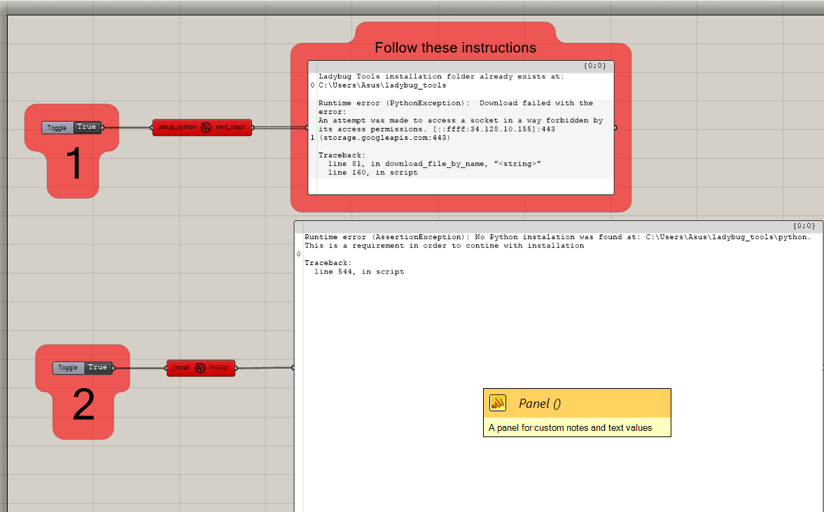

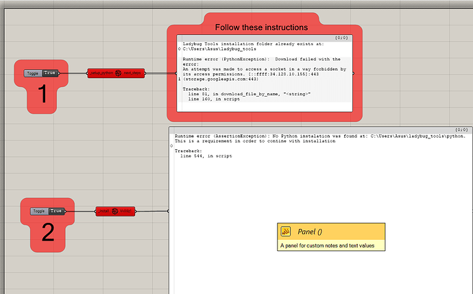

I’m not really familiar with rhino and its plugins, and I’m trying to install ladybug. However, when i tried to run the ladybug installer grasshopper definition, i encountered an issue that goes like “an attempt to access a socket in a way forbidden by its access permission”. I’ve turned my antivirus off, run rhino as administrator, tried downloading the 1.8.0 version and i still got the same issue with different tracebacks. I’ll attach the screenshot below

Not a direct answer - however i find the single package Pollination .exe much easier - then you know you have all the right dependancies. As long as you have admin permission for the install like any other program. Give it a go.
If you are in China or another place that blocks downloads from certain websites (like Google cloud), then your two options are:
  1. Use a VPN.
  2. Use the Pollination installer as Leighton suggests.
