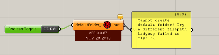

Hi there, have faced an issue where a crash happened while I was running Ladybug. Thinking that the calculations were too much and Rhino wasn’t responding, I closed the programme and reopened the file ( and reopened the GH file that was used). However, it tells me that “Ladybug cannot create default folder…”. And it seems I have to redo the whole GH script again. Does this happen often? Because am not sure how to go about fixing this. Would really appreciate the help, thanks !
Not sure what you are aiming for but the defaultFolder_ input should be either blank (then default folder is in c:) or a different file path, not a boolean toggle.
V
Alright, thanks for sharing. I think the issue has been solved. Thanks !
