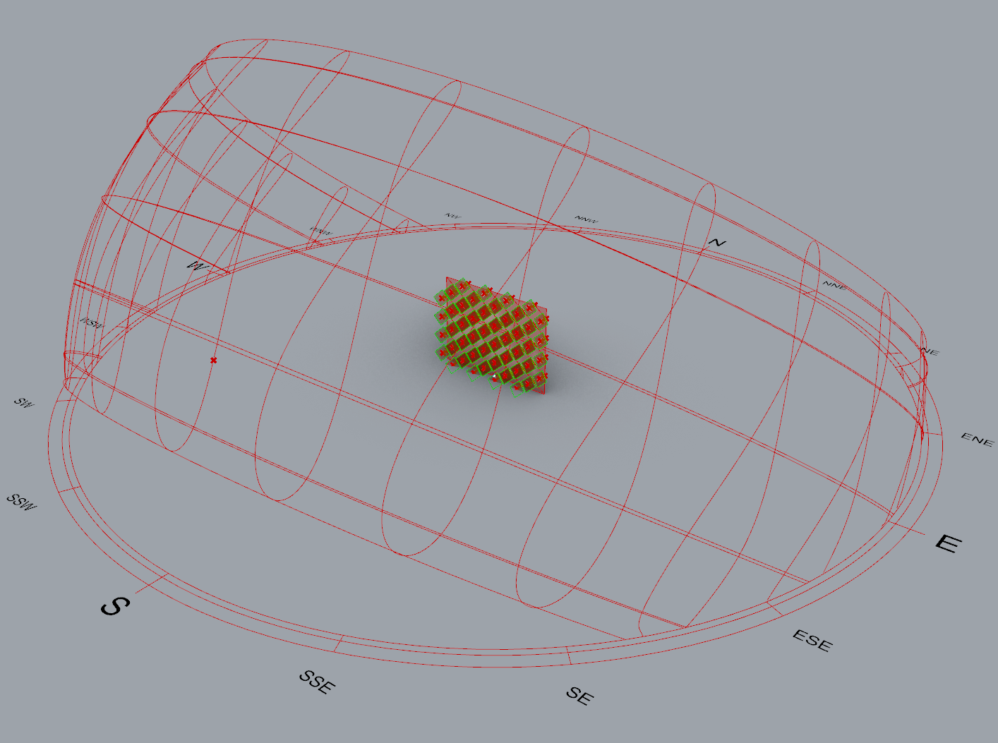

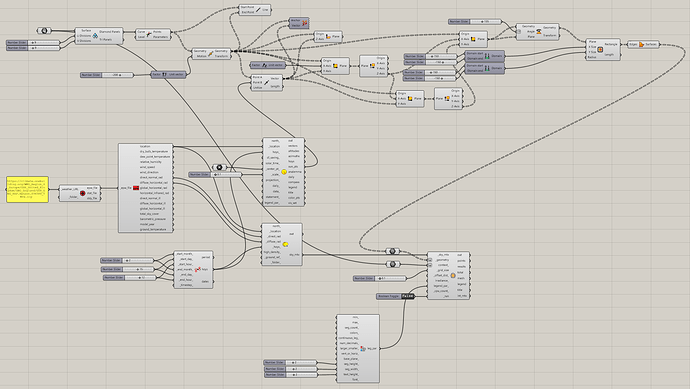

I’m quite new to Grasshopper and I’m currently trying to build an adaptive solar façade simulation.
As shown in the attached image, every time I run it, it just froze and crashes. I’m not getting a clear error message before it closes, so I’m struggling to understand what’s causing the issue. All my plugin should be the newest and I have already download the Radiance file from Release Radiance 5.4 (2023-11-05) · LBNL-ETA/Radiance · GitHub , not sure if that solves it. but please let me know what can i do to fix this.

What is crashing? When you press run or recompute it freezes? Rhino Crashes?
Need some more details or the model.
First thing I would make sure is that your units are not in mm or something. make it meters.
