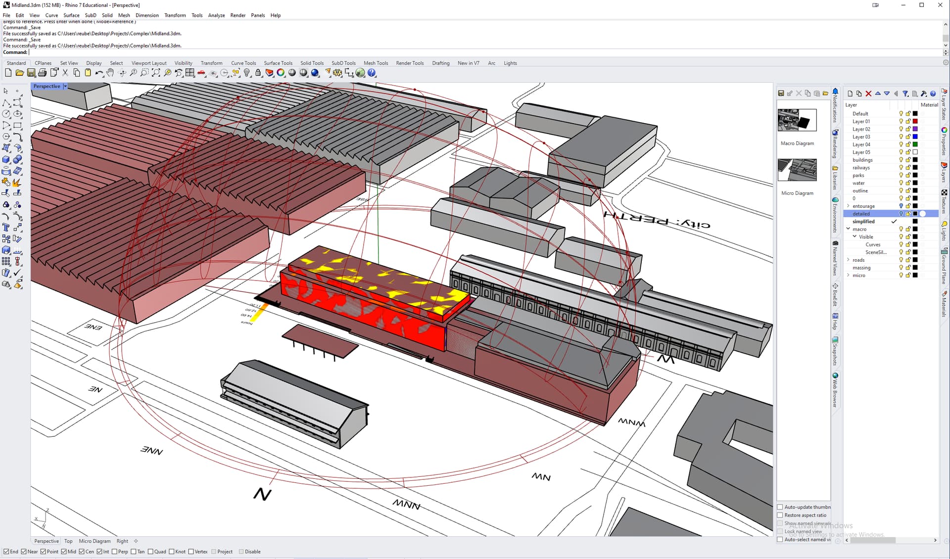

Currently trying to use Ladybug to show daylight hours at an early stage of a project, but the grid of analysis is not showing as I have seen in a few tutorials.
From what I’ve seen, the grid should display as on the BRep surface, but the current display I am getting is strangely shown over the geomoetry, even when I hide the layer within Rhino.
I cannot upload files as I’m a new user, but has anyone ran into this issue before?

It looks like you still have two things in Grasshopper previewing on top of each other, which is causing that messy visualization, even when you have turned off the Rhino layer. Try looking at the component that you are using to bring the geometry into Grasshopper. Chances are that’s the one that’s interfering and, if you turn the preview off on that by right-clicking it in Grasshopper and selecting “Preview”, your visualization should look much better.
Hi Chris,
Such a simple solution, don’t know why I hadn’t spotted it earlier.
Thanks so much,
