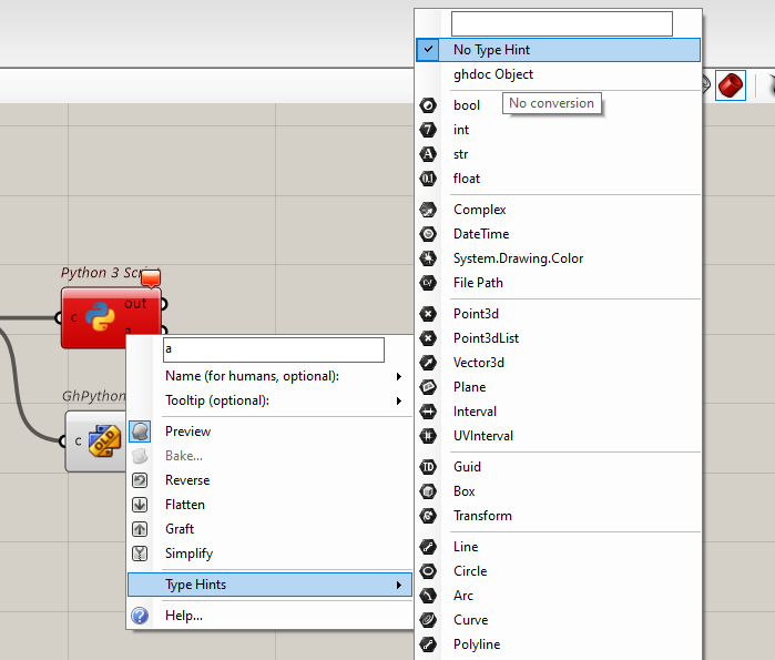

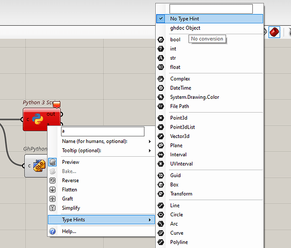

Try to change the output type to No Type Hint and see if that resolves the issue.
Thanks for the input, it didn’t work however. The issue is that once the Py2 object enters the Py3 script, it has lost the class information created in Py2 (in the Honeybee component).
Did you also set the input type to No Type Hint? I get a different error on my machine for not being able to find the path to honeybee which I’m too lazy to edit right now.
Ah, indeed, you need to add some code for Py3 to find the Ladybug Tools path. Changing the type hints does not seem to work - I think @edpmay is onto something when saying that passing objects from Py2 to Py3 does not play very nicely.
