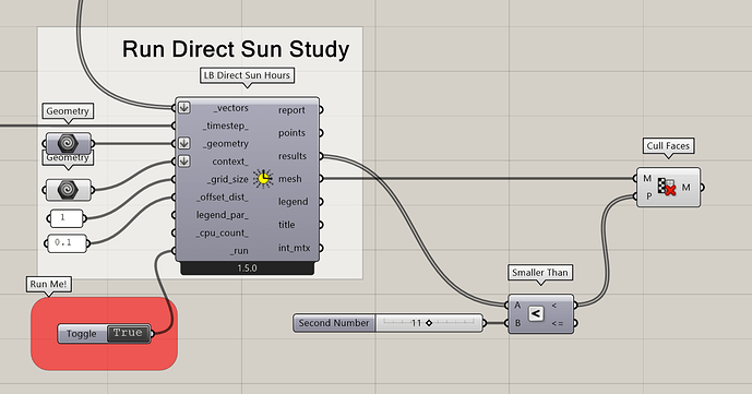

I’m unable to see daylight autonomy results properly and want to replace the MeshSelector with an updated component (version 1.5.0) and can’t find it, as all the other Ladybug components are 1.5.0. Any suggestions?
Daylight simple analysis floor zones.gh (108.8 KB)
The native Grasshopper Cull Faces component essentially does with the Legacy mesh selector did so we haven’t felt the need to make a LBT version of it.
I can’t show an example with your uploaded file since none of the geometry is internalized but here’s a sample with the Direct Sun Hours example file:
direct_sun_study_cull_mesh.gh (32.2 KB)
